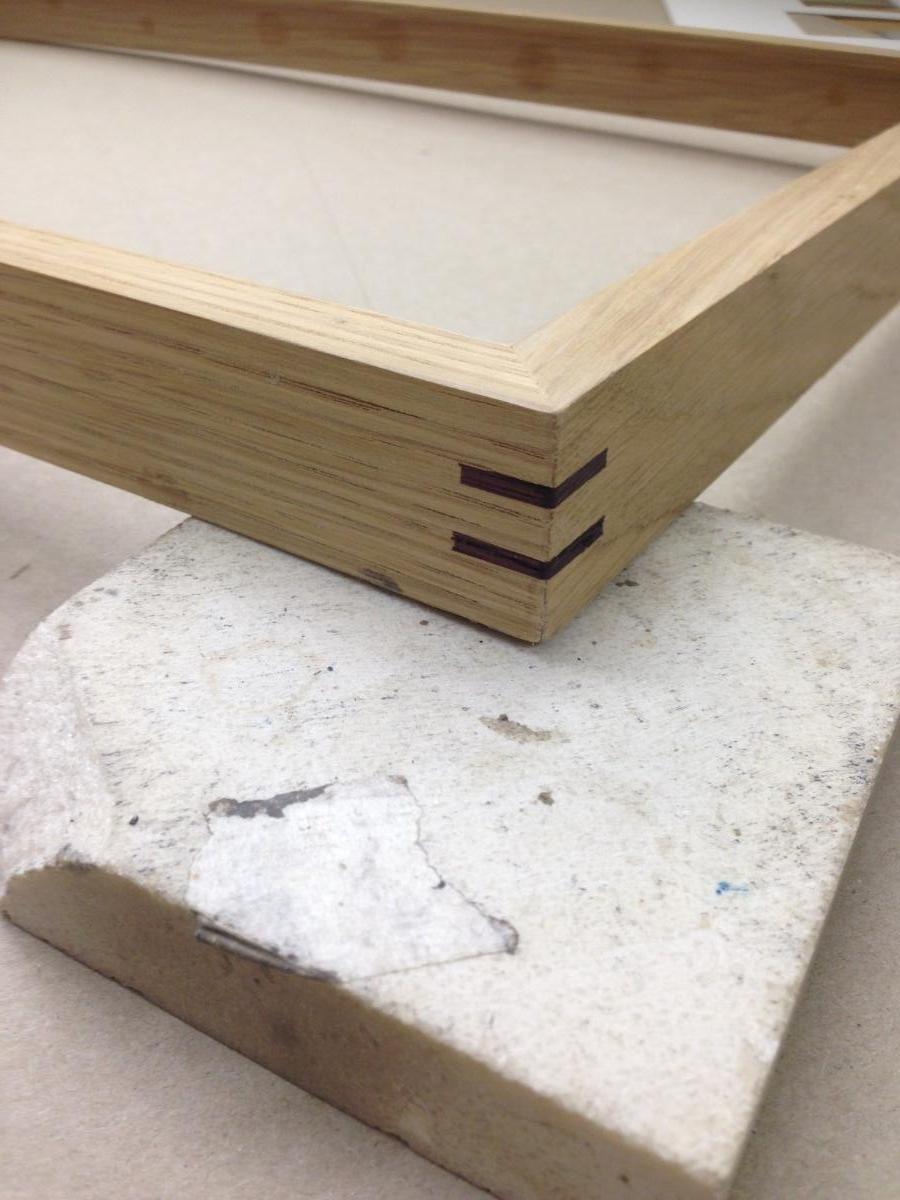

Re: Contemporary hand finishing.
Awesome! What tool/machinery is used to slot the corners, I've seen it on frames before usually with a contrasting wedge?
- Posts: 2547
I've seen Youtube videos of how to make a table saw jig to cut splines.

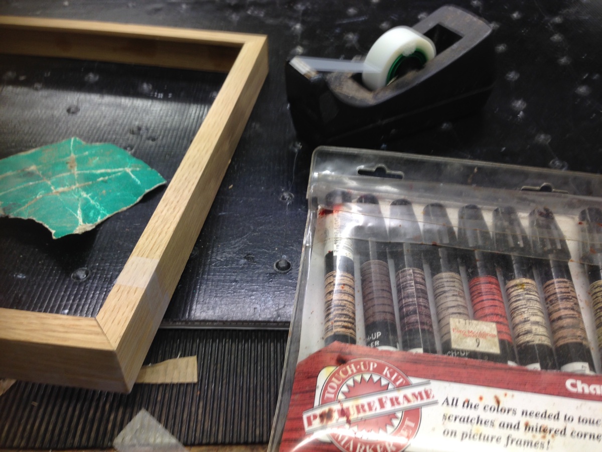

- Posts: 830
I had pretty good results with masking tape and markers

- Gesso&Bole
- Posts: 1013
- Location: Nottingham
I've got a Kreg spline jig that I use on my router table. The Kreg jig works well, but I would probably just make a simple wooden jig if I was starting again - there's plenty of Youtube videos on how to do that. I also have a very small planer/thicknesser (Proxxon DH40) which makes getting the thickness of the spline just perfect a breeze. I also use the planer quite a lot for shadow box construction.
Having said all that - this method, using a cheap biscuit joiner looks like it could be a good way to go, I've not tried it, but it looks sensible (this is just one of several videos I found on youtube)
https://www.youtube.com/watch?v=Ps3lr_CPkiE

- Gesso&Bole
- Posts: 1013
I do them for one regular customer, but only a couple of frames a month,and very occasionally for retail customers. I use a Hoffman to join the moulding, so my splines are for decorative purposes only.
