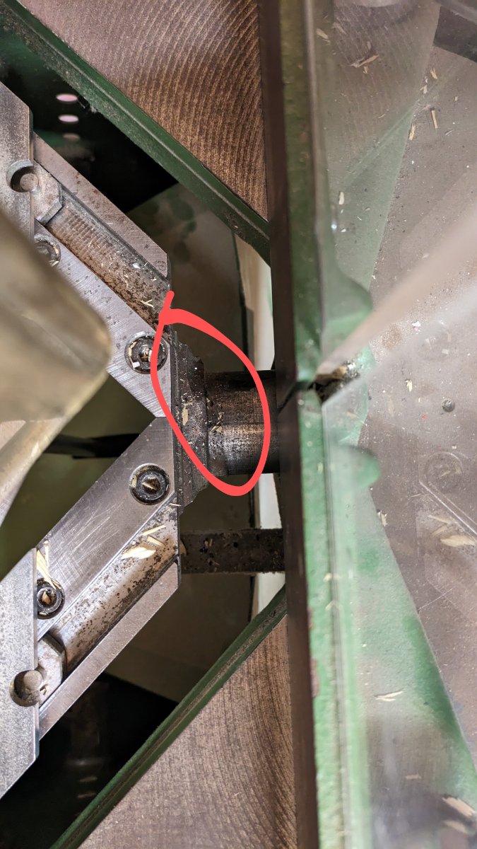

- Posts: 1606
Re: Morso Mitre handle stuck on 13th tooth arc
Here's my contribution -
The cutting block holding the blades, slides on the two rails shown in this photo.
Check there's no wood chips or other stuck inside either of those channels.

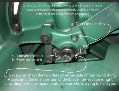

It looks like the nut on the number 1 in the diagram jkx posted is loose have a look at that
Dave
www.iconframers.com/
theframer
- Posts: 453
- Location: borehamwood
- Interests: football,fishing
Should of said you may have to adjust slightly the washer/nut above the bolt you have to watch the blades as it pushes them in and out from the small gap between the fences at the front of the morso do not go to close in or you will cut away at the fences

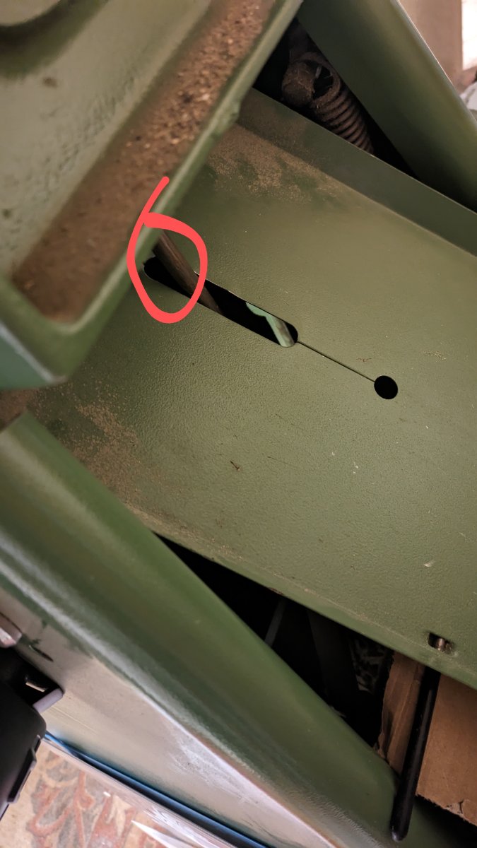

- Posts: 1506
Have a look here, double check nothing is sitting here stopping the blades moving forward.
I assume you don't have the chute thing as it doesn't look it from your video but double check this rod can move freely back and forward.
Check the metal tube isn't hitting the bolt as again that would stop the blades moving forward.
So mystery solved. Firstly, massive thank you to everyone for chipping in ideas. Having bought the Morso off ebay for £150 and made just a handful of frames, I'd have been tempted to give up were it not for everyone's suggestions. Getting it fixed has really made my day.
I feel rather silly at the ultimate cause of the issue, but essentially it was one loose bolt. This one:
I decided to remove the blades and rebate supports to see if it made a difference. Only then did the bright shine of worn metal of the bolt catch my eye, it was immediately obvious this was the cause. Literally a quick tighten and the whole thing runs fine again. The bolt must have gradually become loose from having moved the Morso in the car, then again in the garage, and the knife block was catching it. Exactly what a number of you suggested was the likely cause, but tricky to identify.
Thanks again!
Thanks again!
