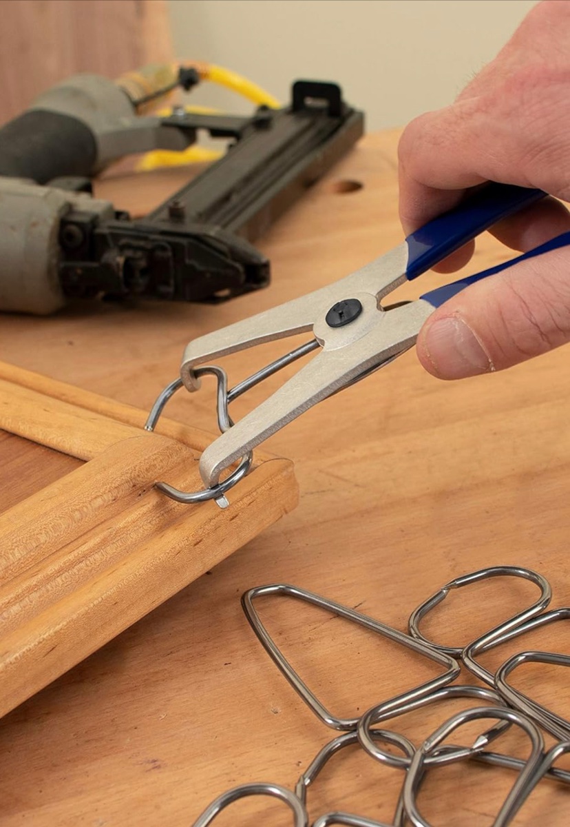

I think the holes are from this type of clamp

Yes that’s the type
Collins / spring clamps
