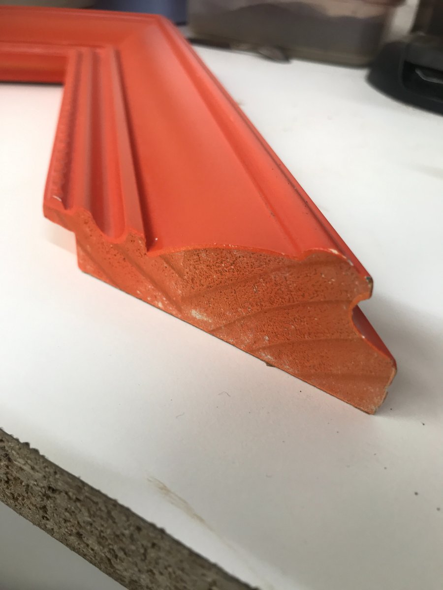

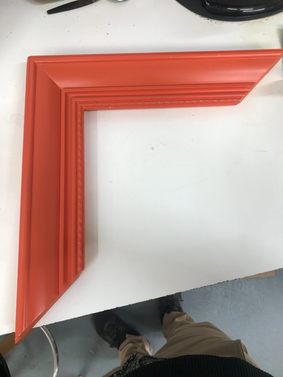

Hi all,
Any ideas who supplies this frame?
70mm Bright Orange swept profile. Please see attached images..
Much appreciated :)

Looks hand finished, maybe prepared for gilding ???
Re: Looking for Frame Supplier For This..
I agree it looks hand finished, if you zoom in you can see some over spray on the cut end of the moulding. I've got a collection of old moulding catalogues from shops which closed down years ago, but there's not anything close to that shape. I'm guessing that it was a special which was machined to order.

Also note that the miter seam appears to be "filled in" with that "orange" coating.

The moulding is from frinton formerly compo moulding and will be on their website
I would guess that a simple satin car spray would do it but do three light coats to stop any runs
Leave quite a few hours between coats.
Code is either F1 or F2 depending on the width you want
Posts: 11621
The profile is used by Frinton Frames.
They typically produce bespoke frames to any size but if you talk to them nicely they may let you have some
lengths ready-gessoed. They also do joined frames gesso only. :D

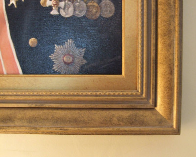

I have frinton galleries set of catalogues and price lists from 2012. There is a picture and also a profile of what is obviously the exact moulding in it, the moulding number is 3" SP, even the size of the moulding profile in the catalogue, when measured is correct. I hope this helps.
