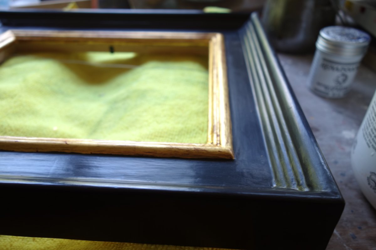

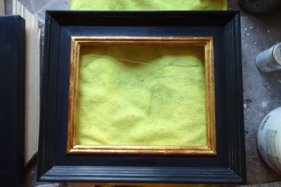

Hello there, I'm hoping I might put a recent frame to you all for critique.
I've produced perhaps a handful of frames now, so it's a good time to take stock. First things first, I'm impervious to taking offence. As with my painting, above all else I'm keen to improve the quality of what I produce. I'm not precious. So please don't hold back. My hope is to get my work into galleries next year, including my frames, so any help I can get to provide more professional-looking frames might make a big difference.
The frame is fairly simple, essentially the only thing I know how to do at this point. It included:
1. Cutting moulding using Morso, gluing, frame clamp.
2. RSG size
3. 6 layers of traditional gesso. Sanded, 220(I think? grit). Water polished.
4. 2 layers of yellow bole, 2 layers of red, then 3 layers of black bole. Polished with 0000 wool
5. Gilded the inside edges.
6. 0000 wool to the gilding
7. Final layers were liquin + van dyke brown
8. Polished with "Renaissance Wood Wax and Polish" and a bit of rag cotton cloth.
I'm learning a lot with each new build. A few things I've picked up for next time:
- The black bole doesn't get as dark as I'd like. It also goes a bit matte. so I'm assuming I need to start looking into shellac?
- burnish the gold leaf more carefully. There's a lot of unattractive marks caused by carelessness. I also managed to chip off a bit of bole/gold leaf by burnishing an edge too hard.
- Try fewer layers of gesso, and the recipe provided by Dermot in the other thread.
Anything else you can help with would be appreciated.
Cheers, Jack

- Posts: 1479
Re: Frame Critique
Well done if you are just starting out finishing your own frames.
There are a few things that might be worth pointing out.
Let's start with the gilding.
Whilst it's good to burnish and distress the gilding on the raised inner detail, the further inner flattish section should be left untreated. This will give the gilding more definition by way of the contrast between the two effects.
The exposed red bole is too loud.
Choose a grey bole from Stevensons Gilding Supplies and paint this over the red. That should tone things down a bit when you rub through.
It might be better to create an ebonised Flemish frame effect by choosing another finishing method.
You have two choices.
1, Paint the barewood frame with black acrylic paint, and using a Venetian Red undercoat.
The paint can be polished a bit with fine wirewool and then apply a few coats of wax.
This will give you a shiny black frame and if that is all you need, then take it from there.
The disadvantage of this is the lack of any depth and the need to fill the grain with gesso or other. Or you could just leave the wood grain showing.
2, This however is the sort of finish which is possible by using Shellac polishes -
Because there is no gesso underlay, the wood profile is sharp and distinctive.
Notice also that although the frame is black, it has a depth and tone which harmonises perfectly with the picture.
If this is what you would aspire to, then all you have to do is learn how to use shellac finishes..

- Posts: 1404
Re: Frame Critique
You have a good star; however, I do see a need for that "wow" factor.

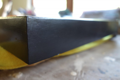

1. Your painted finishes should be cleaned up a bit at the union between the gilding and the painted surfaces. The transition should be a crisp straight line.
2. I see a need for a bit of finish sanding before the wax is applied. It is not that smooth. I do not know what type of brush you are using. Have you considered using a self leveling paint?

- Posts: 15
- Joined: Sat 16 Dec, 2023 9:48 pm
- Location: Llandeilo, Wales
- Organisation: Painter
- Interests: Studying art.
Re: Frame Critique
Apologies for the delayed response - just wanted to say thank you for providing feedback! JFeig and Dermot. A lot to work on
JFeig you mentioned a couple points.
1. On the lack of a crisp line between guilding and paint. It sound ridiculous but it hadn't occurred to me to use masking tape to achieve this until I saw a picture on Dermot's website, ha. I just tried to keep it straight by hand. So I'll try the masking tape next time and hopefully it'll be cleaner.
2. Self-leveling paint, no I haven't tried it. Any recommendations? I've never heard of it tbh. I have struggled to get a smooth finish. I've assumed I'm just not very good at sanding the gesso layer? For applying the gesso I've been using a watercolour brush, as it seemed to be the least streaky. I have a string bound brush, but this leaves a very visible brush mark.
Thanks again both!
Thanks again both!
