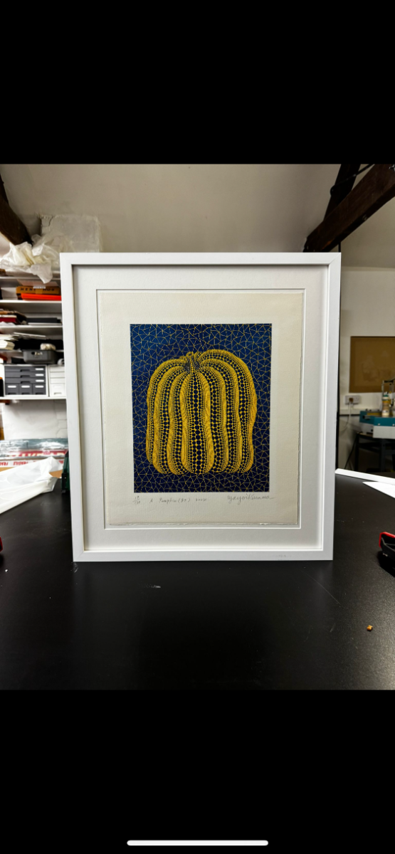

Could you not float with a mount? Shadow mount?
Not sure how to add photos otherwise i’d show you
- Posts: 1479
Re: float mounts and fillets
Yes, that was the sort of thing we were talking about.
But the discussion went a bit sideways for a while.
