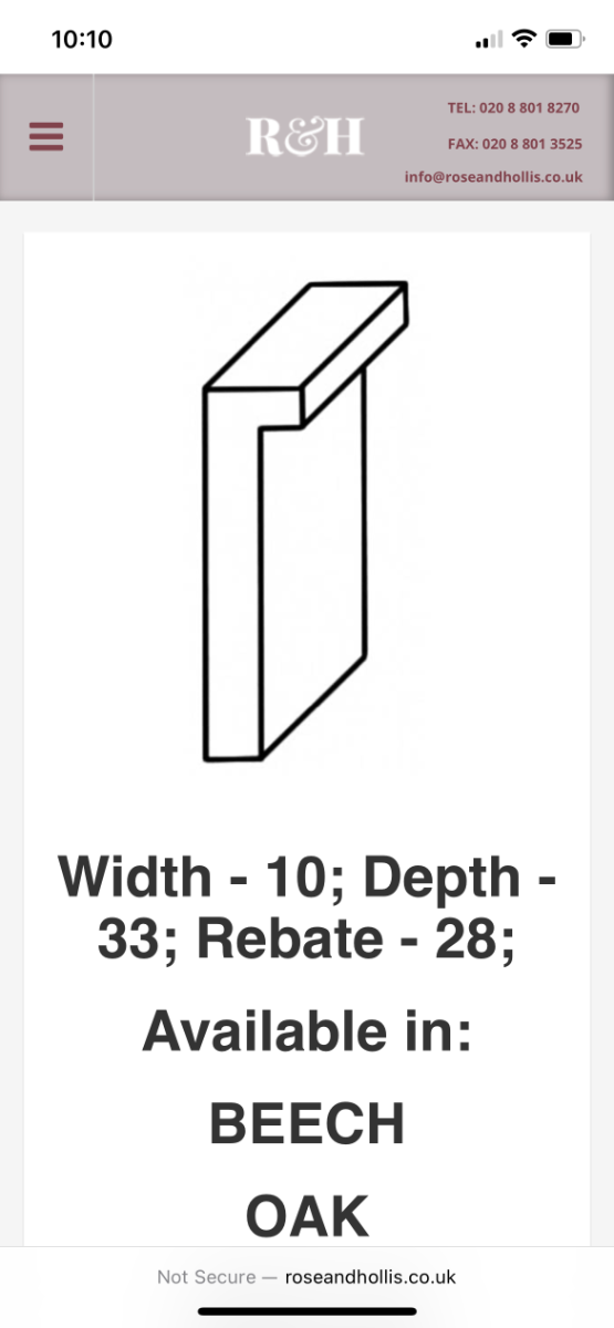

In preference to hijack a topic rather than start another thread I wondered if I could move this discussion on to nail guns, in particular brad guns and headless pinners. Its high time I added one of these to my arsenal. I am finding a real trend for narrow tall mouldings at the moment (particularly R&H A354 - all wood types) and finding the traditional method of mitre vice and hammer not only time consuming but a little brutal and often leading to less than satisfactory results.
My preference would be for a weapon that does both brads and headless pins, and quality is important - I plan for this to be the one and only I ever buy. Research has led me to the Omer 12.40. Any one have it? It appears that will shoot both types. Apparently 18 gauge. Is that suitable for pinning these type of mouldings? Brads or headless pins?

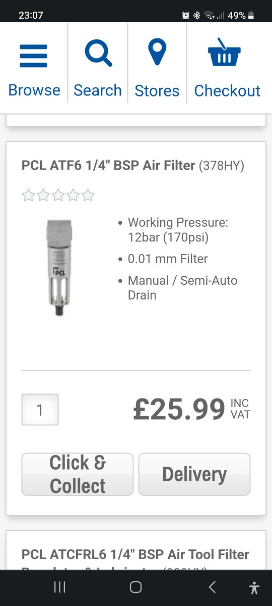

I'm going to put one of these pcl filters from Screwfix on the all singing and dancing Antistatic air gun when it arrives. To be sure to be sure.
I'll sleep just as easy as with the £200 Lions super filter.
