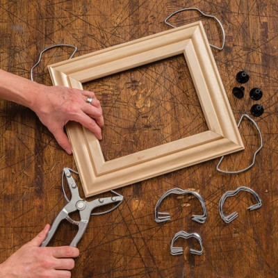

I always make such frames with a raw wood profile and paint it after joining. This way you can clamp/nail it as you wish
and make good any nail holes in the finishing process. You can also colour it to you individual requirements and if it gets
knocked you can repair it perfectly.
In such circumstances these clamps are very handy. At one time every framer used them. :D

prospero wrote: Fri 27 Dec, 2024 12:00 pm I always make such frames with a raw wood profile and paint it after joining. This way you can clamp/nail it as you wish
Is there a particular name for that type of clamp in your pic, Prospero?
Posts: 11697
Re: Assembling a tray frame, high rebate
They were originally Ulmia brand which I think you can still get but they're quite pricey.
I got a similar set for about £30 which work OK.
Search "Spring Clamps". :wink:
