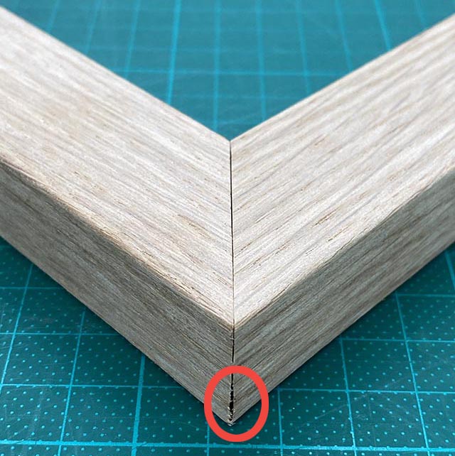

We run a small print and framing studio in Auckland New Zealand and need some help sorting our frame chops on our Morso guillotine.

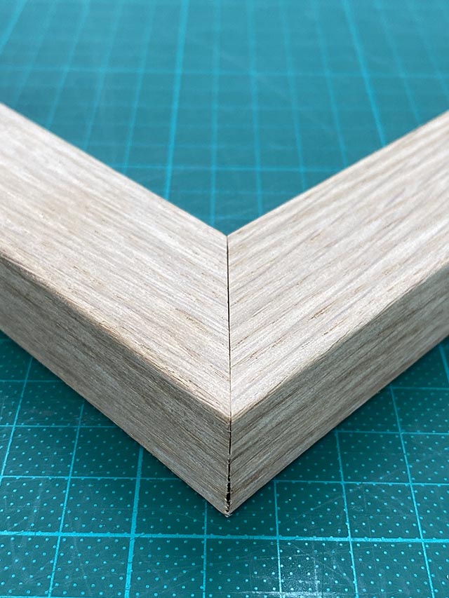

The bottom edges of the cut seem to be angled no matter what adjustments we make, even though the top join is fine.
I have replaced the blades, spent several hours "fine tuning" and everything in between... but the issue persists.
Any help and advice would be more that welcome at this stage.
Thanks.

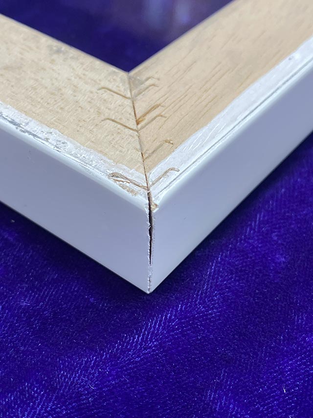

Based on that photo my first guess would be that you've got the wedge too close to the outside edge
Posts: 2356
Re: Morso Chopper Issues
Post by Justintime »
As Steve says, that outside wedge is far too close to the outside and is pushing the mitre open. Your outside wedge should be just past halfway no further and the inside wedge should be as close as you can to the inside.

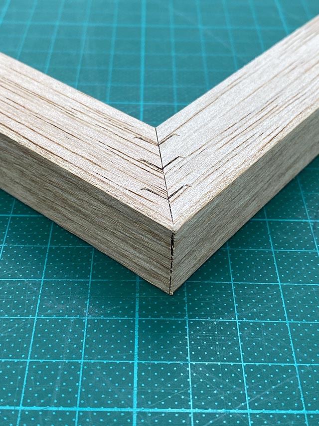

If you chop a square section moulding very close to the end there will remain a flat section, look to see if it is parallel. If it isn't then it's a chop problem, if it is then an assembly issue

The join in the pic was un-joined and re pinned after a measuring fail ;-0. Hence the multiple nail marks.
We usually double stack three nails on these joints.

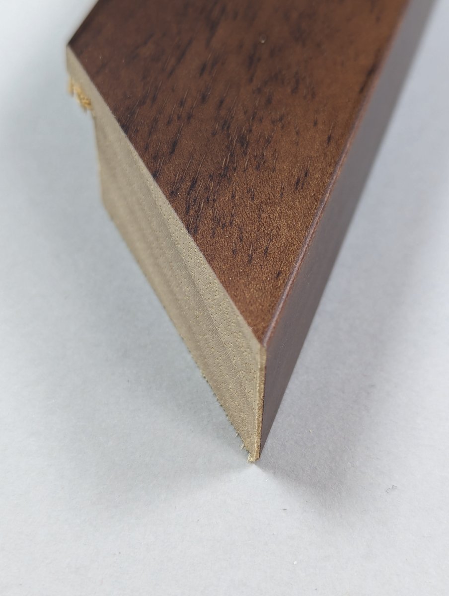

The chipping on the gesso coated mouldings is a pain in the butt... but we have little alternative with local suppliers. Suggestions welcome.
The main issue is a noticeable "nick" or on-even cut on one side of the join.

Assuming that you're gluing your joins, get a Stanley band clamp and clamp tight after joining and leave overnight. See if that improves it. Stacking can be unpredictable. I'm guessing a single 15 would do. I'd go even closer to the inside and two wedges should be sufficient. Some might agree the middle is overkill. Imho the glue and clamp is most important. The wedges hold it together if the glue fails.

Faced with that light grey moulding I would gently sand the chippy bits and then rub over with the said glue to fill
the gap. Wipe off any on the outside while it's still runny. (It dries fast). Then a quick dab with a matching mix of
acrylic paint and job done.
For the woody one do the same but use something like Brummer Stopping. Quick tickle with a sanding pad - Bingo! :clap:

What really puzzles me is the weird "nick" on the one side of the chop. It's like the blade is moving during the cutting stroke, but all the guides are solid and well lubricated.

Regards the back, the blades may need moving forwards slightly in to the groove between the fences, but it may also be a case of bad positioning of v nails - I think you have too many and unless you only use 7mm v nails or something, stacking shouldn’t be necessary on that profile.
