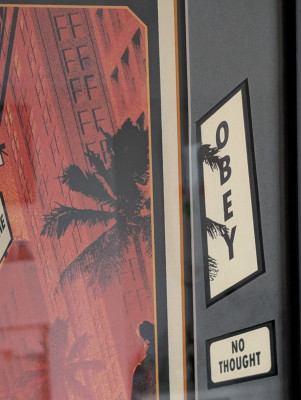

I just wanted to post my last 2 projects, completed this week, for some feedback.
As can be seen in "They Live", I'm having some issues with cutting random shapes without using the stops on my Ultimat Gold, resulting in some small overcuts but I'm hoping to iron that out with a bit of measuring but any advice on that would be greatly appreciated!

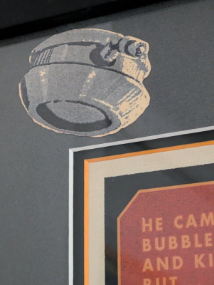

This made me smile, new mount for a job - the green one I cut underneath, the original ran out 10mm over 550mm, the sides were fine, the customer hadn't noticed for the 20 years on her wall!

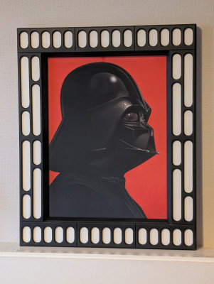

@rinzleriston I missed your post back in Feb. I can't believe noone else commented on it! These look amazing! Did you create and build the Darth Vader moulding from scratch?
