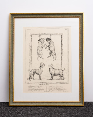

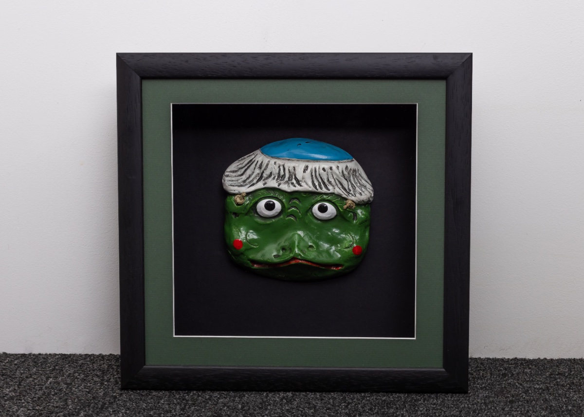

Hi Everyone,
This section of the forum seems like a really useful idea for newcomers, so Id love to get a little feedback on these examples.Interested to hear what people think in particular of the design choices and any other little details worthy of note. What would you have done differently, or to better these? Any comments greatly appreciated - don't hold back!
A few notes...
pigman canvas - a pretty basic, understated frame so room for more. However, would it better suit a light frame, given the colours?
dog tax - I can't help feeling more could have been done with the mats. More maybe, or a v groove? Needs to be wider? Would a more classical frame have done the picture more justice?
kappa box - again, now feeling more could have been done with the mats...but not quite sure what.

I would possibly have a different mount colour on the dog one to give more of a contrast, or add a bit of colour with a double mount, but I definitely wouldn't add a vgroove as it's already quite busy.
For the Kappa one I would have possibly made the mount wider, or got rid of it completely and then changed the colour of the backing mount, or just had a colour on the spacers.

2.I'd have used a, warmer mount, preferably a rag mount. I'd have done a double rag mount with V groove, wider too and bottom weighted. Moulding is perfect for the piece.
3.im not a fan of window mounts in a box frame. I prefer matching spacers. If it's hard to find a matching mount or one that is in the tonal range it's best not to try Imo. The moulding is OK, but no wow factor. The piece is not centred in the frame.

Ah, so you would hold off on something like a v groove (or multiple mats) if the imagery is quite busy? That does make sense when I now think of pictures I've seen with grooves on. In terms of the mount, possibly just a grey, or any other stronger "off" white?
For the box, I'm embarrassed to admit I haven't worked at all with spacers - this needs correcting. Again, this makes sense as, if you have the depth on a project, those elements can be better exploited.

1. You're right - those corners look a bit gnarly. It's a good job none of these examples are for clients, and only just my own practice materials. A smaller shadow gap...I imagine this is a common mistake: folk going overboard with wide gaps that distract from the picture. Out of interest, how to do you set the gaps? Do you use fillets?
2. Rag mounts are something I was hoping to attempt in the near future. Do you make them from scratch using a normal mount and the fabric, or can they be purchased as one?
3. It sounds like spacers have really been the overlooked element of this work. Fair comments about both the mount and frame - this does look a little underwhelming.

I would aim for the 'air gap' to be approx 5mm yours looks a bit wider than that.
Mitres could be better - use a strap clamp
Choice of frame looks perfect.
Dog Tax
This looks like it is well executed - I think the moulding is a good choice.
Using a whiter mount than the image, tends to make the print look dirty. This is why there are dozens of different whites.
I think I would have gone for either a double mount with a 4mm darker colour showing underneath (although this can look a bit 'modern' for that type of image) or a single mount line around the aperture. Either way I would go darker on the mount to make the image look a bit cleaner.

I agree with Justin on window mounts on shadow boxes. I would use the same mount board to make fillets for the side of the frame - much cleaner. I am generally happy for the bottom to be weighted slightly this is a bit extreme. (trick here is to attach the mask to an oversize piece of board, and then mark it and trim it to size)

@RobM I use some pieces of foamboard to set the canvas in the float frame. If I've cut the moulding for a 5mm shadow gap some 5mm foamboard pieces should hold it in place, if not squeeze some 1.4 mountboard pieces in too til it's tight. Fix with screws from below and remove foamboard.
"Rag mount" is 100% cotton mountboard as opposed to alpha cellulose paper mountboard. It's Museum or Level 1 board, more expensive and much more premium looking Imo, perfect for this sort of antique print.
For fillers I prefer the CJ Paste or Cc Paste from Lions I never got on with the Amaco waxes. Have a damp sheet of kitchen paper handy, squeeze a bit onto a gloves finger push into corner, when all four corners are done leave for five minutes and carefully clean up with the damp paper. Do it all again if required. That's for white black brown etc. If it's gold or silver etc using a bit of ronseal smooth finish wood filler, clean up and rub a tiny bit of Rub n Buff golf leaf etc over the filler.

I'm now seeing what you're saying about the mount on dog tax, and I'll aim to amend for others. I've got a similar print so may try that one with another mount for comparison.
Centering the items in boxes perfectly has been a little more tricky than I'd anticipated. Going forward, I'll use the method you've suggested.
