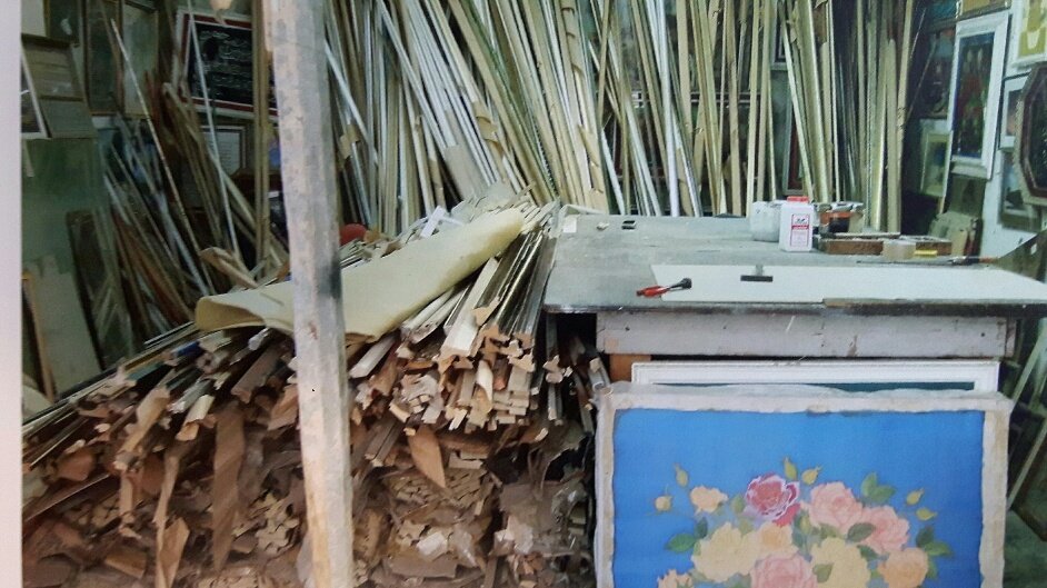

[attachment=0]A frame shop in UAE
When you have finished I know another framer who needs a bit of a tidy up
