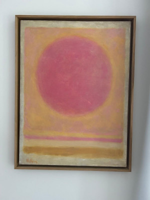

My wife was commissioned to create something similar to this painting:
She is working on it now, but she paints on a 7.5mm thick board.
Client likes the idea of a L frame with a shadow gap like the image above. Would of course be easy if the painting was on a canvas.
What method would you use to create a "visual thickness" to the painted board?

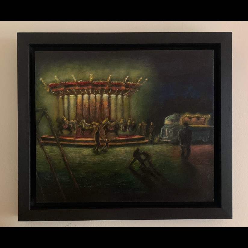

for this i make a spacer frame that sits smaller than the artwork board (so you can’t see it ) but overlaps the tray frame so that cone be attached easily. Spacer frame needs to be the right depth so the artwork is sitting lower/ back from the front of the frame. I use really strong ultra thin Velcro to fix the painting to the spacer so the artwork is not damaged and can be reframed if they want and the spacer is attached to the frame with offsets.
See pic…

Makes a lot of sense to use spacers rather than the solution I thought about (use a foam board and double side adhesive). Thin velcro is a fab idea for positioning and also making it easier to alter the frame at a later stage if need be.
Thanks a lot for this. I am learning, learning.
