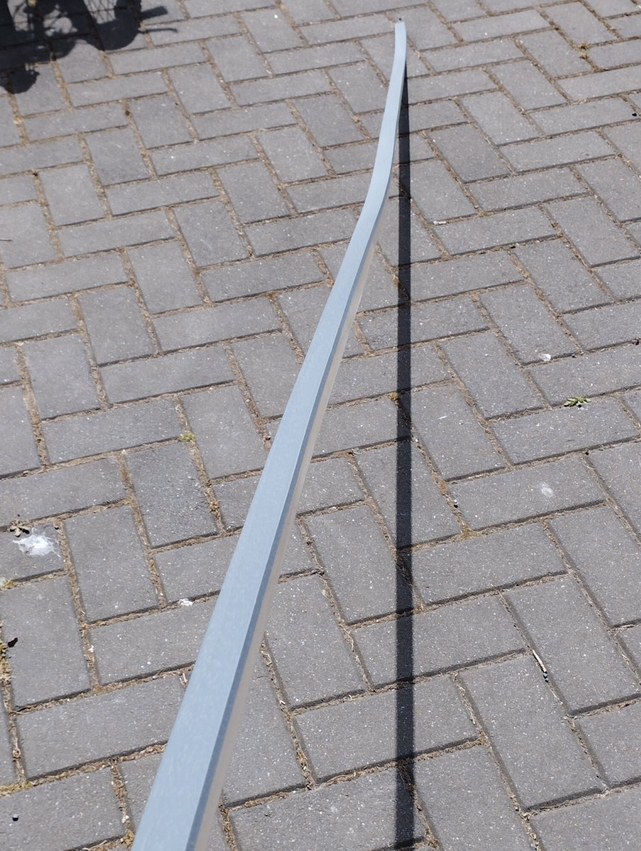

Always best to check mouldings for warping and twisting by casting your eye down the length.
I collected this batch last week from a major supplier - the lengths were wrapped.
But after I unwrapped them when I got back ..... !

I have had this problem with the current vogue for flat mouldings and agree with the findings of twisting and varying heights along the length of a piece. I solved this by buying two Masterclamps from the USA which have a positive grip and an adjustable fence which is very handy in wider mouldings and with a bit of attention when tightening the join the surfaces can be made flush. When dried I underpin as per usual, with the proviso that I use a venerable Euro foot operated model and apply pressure gently to avoid any stress on the glued faces. A lot slower than underpinning only but gives a far superior finish.
