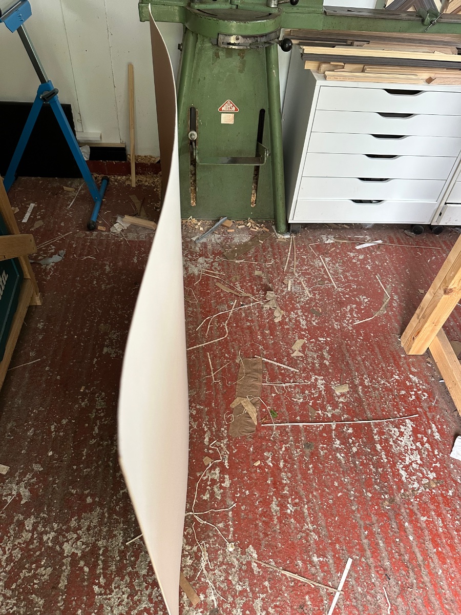

I tend to use Kraft lined boards for my frame backs, but have always preferred corrugated board. I know Corri-cor is supposed to have a slight bow which helps the artwork stay flat - while it does have this bow, I always seem to get sheets that have more of an 'S' or an 'M' shaped bow along the length. This means that the bow is fine at certain points of the board, but then bows the wrong way in other places! I use Corri-corr Mark 3 and just bought some mark 4 to see if that is any better, but that has the exact same 'M' bend. I just wondered if this is just how it's coming from my supplier (Centrado) or whether this is just how Corri-cor is? Is it worth me getting it from a different supplier or trying Artbak instead?
The first photo shows a sheet cut into 4 16x20" backs. You can see two bow the right way but two bow completely the wrong way
I buy a lot of mount board from Lion so could get it from them, but they only do backing boards at 1200x800 and I cut more 16x20"s than anything else so can't get 4 out of a sheet that small.

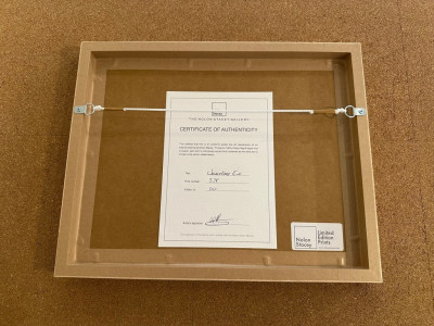

I like white frame backs, with foam board and white gummed tape, or correx and lineco aluminium sealing tape.
I also like the US Dustcover method, this one uses thin black card, but any colour you like could be used.
(Your cord is too tight!)

Re: Corri-Cor bowing
Id say when hung, the cord is at least at 15 degrees so for my 1-2kg frames, that’s all good!
