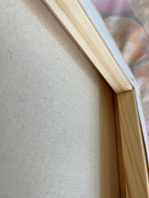

My brain is spinning and frozen at the same time. I’m sure I have attached similar before. Now I don’t know.
I have already cut and glued the moulding.
It’s printed mass production ”art” so if there is a solution but not by all the rules it’s ok by me.
Can’t explain see pictures

If you are asking, how do I attach the art into the frame, here is one answer.
Use offset hardware. They come with one or two holes, depending on the manufacturer, for the attachment of the "single step" bent metal strap that is screwed into the frame. They come in sizes from 1/8" to 1 1/4" (3-30mm).

I would take it off the deep bars and remount it on shallower ones. (20mm?).
These things are done so that they can be hung without a frame and the deep stretchers give them more 'presence'.
You can use offsets but on a narrow moulding you run the risk of the hardware being visible from the sides.

Option 1, as suggested by Jerome; canvas offsets but as mentioned may be visible
Option 2, as suggested by Prospero; re-stretch on slimmer stretcher bars
Option 3, re-make using a deeper frame
I would be on option 3
