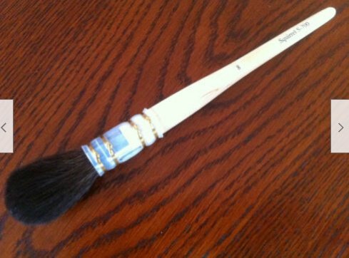

One is a Squirrel Hair Polishing Mop and this is best suited to wide flat mouldings. In using this brush, the operator will soak it in shellac, press out the excess polish with gloved fingers and shape the brush into a wide chisel. When pulled slowly across the moulding, the shellac will form a smooth wet varnish completely free of any brush marks.
The only downside here is the price, The most useful brush size, no.10 is £50 or so.
A cheaper alternative is to use a flat 3/4" 'One Stroke' watercolour brush. A Pro Art Prolene is a good reliable brand. This will serve well on narrower mouldings.
