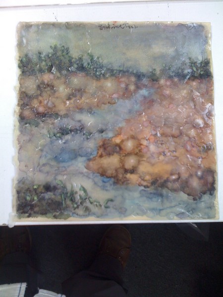

I am tempted to float hinge the work onto a rag mat that is slightly larger than the work itself. This way, the rag mat can provide the support for the work as well as the solid surface behind to reduce the translucency of the piece and thereby hopefully will hide the hinges as well. However, the next challenge is how to hinge the work with the back of the work waxed as well. The challenge is to hinge the work and tro ensure that the hinges stay for as long as they should.
I am attaching an image of the work in question. The good thing is that the work is rather small.

You're going to struggle to attach anything to that wax!
I'd use an encapsulation method(or ask the customer if they mind me making holes in the artwork!)

Steven. Have you thought about using folded Melinex strips along the edges? The only complication with this is the writing at the top which leves little room to play with, but strips along three sides should hold it. Maybe you could get a narrow strip along the top just enough to prevent possible slippage.

Well, the job was finally done and the client was happy with the results. From all the contributions over this thread, I have decided to float the work on a piece of Rag mat slightly larger than the work itself using "photo corners". I even had to make a penetration on one of the photo corner as there is a small blurb of wax protruding from the otherwise straight edges to accomodate it.
I then iserted a layer of acid free fomaboard to furhter raise this floated image away form the backing Rag Mat. Finally, the whole package is assembled with spacers and turn buttons. I ahve asked the client to look out for any off-gassing from the wax and in case there is, she can just release the turnbuttons and open up the package for airing on her own.
Thank you everybody for your contributions and suggestions.
