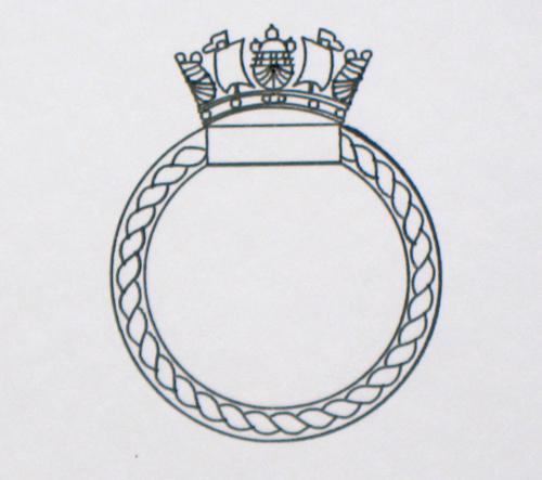

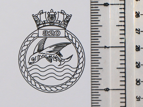

Following are some images of the MatSylus Pen Head.
Being out of focus is my fault, not the CMC.
All work was carried on Corel Draw 9 and drawn Free Hand from a JPEG image.
Due to there being so many elements involved in the creation, I had to split it into two seperate .PLT formats. This did entail two runs of the Pen Head. Time taken to complete both images was in the order of 2 hours. Time to print each .PLT was 3 minutes. Aligning the two was very criticle.
They are from 'First Run Only' so will need some rework. The external crest above and the internal logo below. In hindsight this will help in future as it is the internal Logos which will change with requirements. Whilst the External Crest is standard. Below the first run image of the two combined.
As you can see this image is only 50mm (2 inches) in height.
The pen used for drawing was the PILOT 0.5mm. In future I will use the 0.5mm for the external Crest, yet step down to a 0.3mm for the internal Logos.
