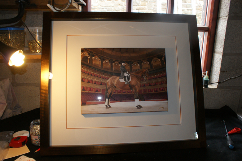

Hello,
I framed a stretched canvas (gouache) recently. It didn't look right with any moulding I tried next to it, so I did something a bit different. Attached it to mountboard from the back (screws thru the mount and into the frame with an extra piece of backing board behind for strength) and then a double mount, with a deep rebate moulding with spacer bar. The customer was thrilled. I've tried to upload an image here but it has too many pixels so let me know if you'd like me to email it over to you.

Re: how to frame this
Ah thanks Ormond. I need to catch up with you clever guys. I have Corel pro photo something so should be able to resize on there - I'll have a go...... and then I can show you all my beautiful framing
- Lee Gent resized.jpg (192.36 KiB) Viewed 4498 times

Yey! It worked!! Thanks again Ormond!!!

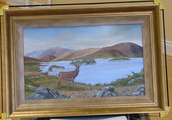

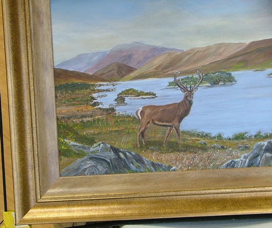

Re: how to frame this. Update
Here is the promised final result.
And this is my final answer.
Ive phoned a friend(emailed actually, Thanks Lynda)
Asked the audience(Framers Forum)
And brought it down to 50/50
Final Answer attached.
I hope brings me nearer to making my first million
The inner scoop was hand painted in acrylic using Raw Umber, Burnt Umber, Buff Titanium and white. Two mottled coatd and finished with three coats of dark beeswax.
Thanks to all for your valuable time and feedback. Much Appreciated.

Lyndy,lyndyloo wrote:Yey! It worked!! Thanks again Ormond!!!
You're welcome, but I didn't contribute much.
Tip: See how the sides of the frame appear to be bowed? That's called 'barrell distortion' and when the sides curve inward, it's called 'pincushion distortion. Both of those can be fixed in Photoshop, Gimp and some other software. Maybe fixable with your software too.
One way to minimise this distortion is to stand further away and zoom in, but you may need a tripod to stop camera shake.
Philip,
A great improvement over the orginal design. It looks great because the colours are in harmony with the image!

The easiest way to fix it is to use PTLens from ePaperPress (http://epaperpress.com/ptlens/). It comes as a standalone application or a Photoshop plug-in. It reads the lens data and settings from the file and automatically corrects for any distortion. For barrel or pincushion distortion it's a 'one-click' solution.Nigel Nobody wrote: Tip: See how the sides of the frame appear to be bowed? That's called 'barrell distortion' and when the sides curve inward, it's called 'pincushion distortion. Both of those can be fixed in Photoshop, Gimp and some other software. Maybe fixable with your software too.
If you also want to correct for lens aberration and other possible distortions then it might mean adjusting a slider or two.
Every photograph I take in the workshop gets fed through PTLens as standard. If the camera were attached to a Mac I'd make it an automatic action but I don't know how to do that on a PC.

If in doubt - why not try black ? Going for a gold or silver will drain the colour in my opinion.
