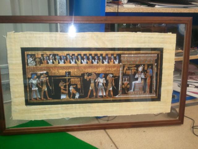

re this problem, I am about to do the very same thing although mine wont end up in the bathroom. I plan on doing a double glaze mount sandwiching the papyrus between two sheets of Non reflective glass and then mounting in a suitable frame, only way i seem to think of a good way of "sealing" a double glaze would be by using Poly sealer or something similar as long as it is a clear product, i would begin by putting as much weight on the glass as possible and then taping it with a strong tape, then run a bead of sealant around the outside edge on the two joining edges of the glass, thus Sealing the Papyrus. Let this set for the recomended time and then frame in suitable frame. only major problem would be how to fix the completed double glaze job in the frame with out having nasty flexi points showing. Here i would go to the local timber outlet and buy some suitable trim and very carefully nail this to the back of the framein the moulding recess, one could even go as far as to paint the trim to match the frame.
I think this would be called Floating frame type of framing job ill post some pics as i progress.

Re: Papyrus print
here is my finished result of the Papyrus print in double glazing.
