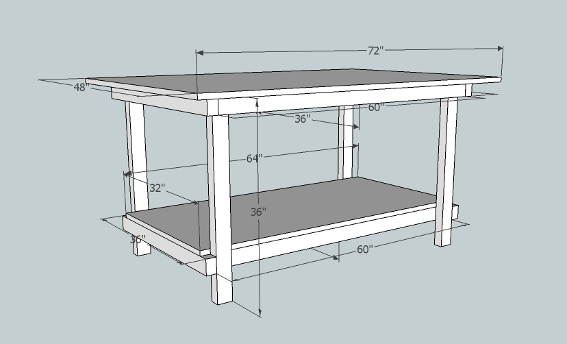

When I was making benches I could not find any designs, so I did some myself, here is one for a 6' x 4' bench, which I think is a good size:

- workbench 6x4.jpg (125.49 KiB) Viewed 4958 times
