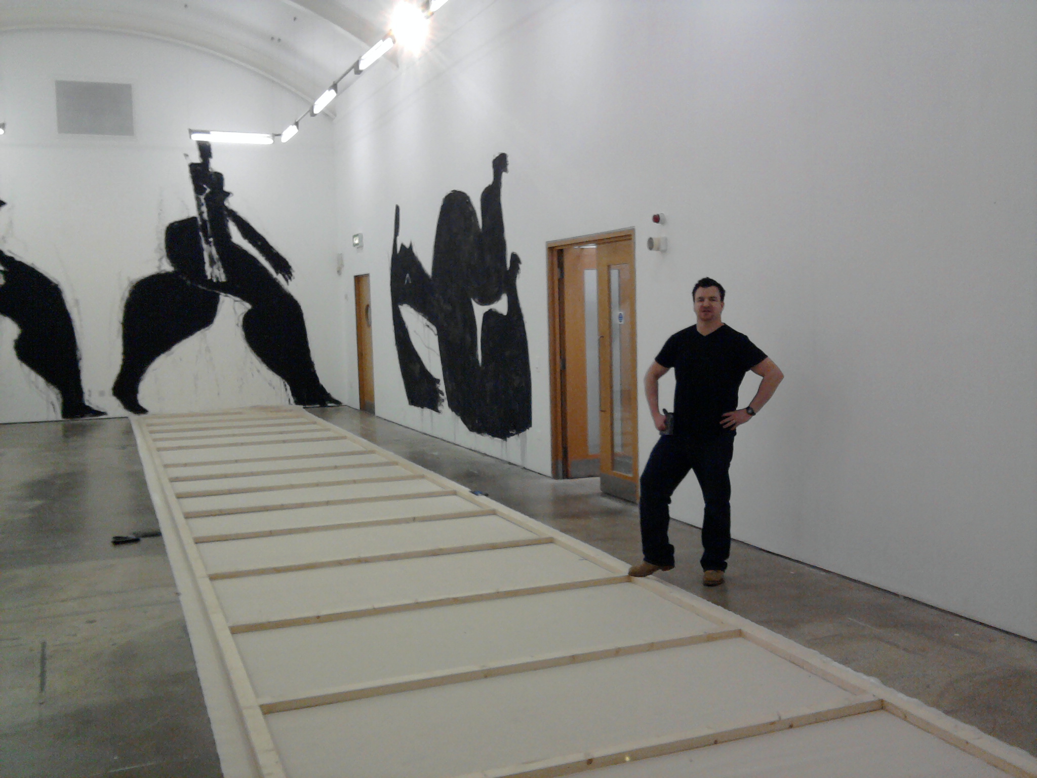

I am an artist and a picture framer and do some occasional 'Art Tech' work at the Ormeau Baths Gallery in Belfast. I was asked to stretch a 60 Foot x 9 Foot canvas for an artist called Neil Shawcross, for an exhibition called 'Into the Black'. The support was constructed by a joiner and the canvas was a role of 100 Foot sailing canvas. It was rolled out and primed with a brush about 10 Foot at a time, allowed to dry then re-rolled up and continued until all 60 Foot had a first coat. The floor of the gallery was then brushed and the supports lifted on top of the face down canvas. Myself and another technician then started at the centre and worked facing each other pulling and pinning the canvas about a yard at a time on each side of the middle until we reached about 5 Foot from each end. We then worked on each end and the sides, working out to the corners as normal and finishing the corners in the traditional way. It then took a team of 5 people to turn the canvas over. It was given a further two coats of primer with a roller on a pole. No conversation methods were used in the construction as the canvas will be cut up and put on proper supports after the show. The Artists painted a mural of dancers with the canvas still on the floor. It was later lifted on to large 5 inch screws drilled and plugged into the wall. Visit http://www.ormeaubaths.co.uk
Q is this a Forum record for making a canvas?
Please see attached photos.

Biggest single photo canvas print we stretched was 3m (usual stretcher bar profile), but we have done 4m as multi-panel and can't recall a larger one, I hope one day to get a job/excuse to do a huge multi-panel one - Hockney style.
I imagine doing a 60 footer is fairly similar to a 10 footer, but were there any issues that came up unexpectedly to beware of e.g. huge stretch required on length for tautness? bowing of frame? wrinkling, etc?

As we had no idea how to work on such a large canvas we just tried to work it out as we went. As the canvas was on the floor and the supports sat on top, the waight of the supports helped to keep the length of the canvas tight to the frame. Every two or so yards we pulled the canvas tight along the length of the support using a 'carpet fitters kick'. Which means you grab the corner of the canvas with your hand and give the cloth a good kick to pull it tight. I dought that any other framer or artist will ever use this method again. I've seen the finished work of art and apart from one wrinkle 'about a foot long' in the bottom left had corner, it is suprisingly tight and flat. As far as I can see the joiner made a great job with the support and it has not bowed at all. As far as I know parts of the canvas will be cut out and re-streached over propper bars to make a number of smaller works.

I see you stretched it by hand, that must have killed your wrists, a (couple of) pair(s) of canvas stretching pliers would have been a boon, but seeing as it's going to be cut in to smaller pieces, the crease that they may have saved isn't such an issue.

We tried the pliers but they just got in the way. It was easier to pull tight about a foot at a time and get about three or four staples in at a time. It did kill my wrists though.

That beats my largest stretching jobs...............! Stretching raw canvas and then gessoing after stretching definitely makes things easier to get a taught canvas.
