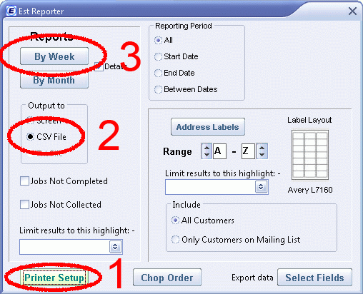

What happens when you select a printer before printing your report? (Details>Reports>Printer Setup)

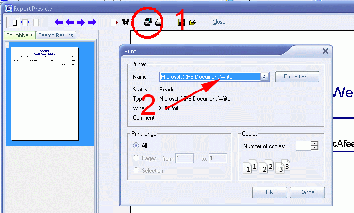

Re: Error - Printer Index out of range
I do click on the Printer Setup in the "Est Reporter" screen, I select the printer, then when I click on the "By Week" button, I then click the Print Icon and for some reason I get a window to "Save file as" an XPS file ??
This also happend when I clicked the "printer setup" icon in the Report Preview screen and selected my printer, its at that point I get the error message I reported . Very strange, cant think why this should just start now.
To print a report:
In the Est Reporter screen -
To preview a report on screen:
In the Est Reporter screen - select output to Screen, then Click By Week (or month)
Then if you wish to print:
In the Report Preview Screen -
Please follow the procedures above and report any errors and describe at what point they occur.
- Select your printer
- Output to CSV File
- Click By Week (or month)
- Print the saved CSV file
- 1. Click Select Printer
- 2. Choose your printer, and click OK
- 3. Click Print
thanks for the screenshots John, I ended up deleting the xps document printr and made my printer the default printer, all seems fine now.
many thanks
Adam
