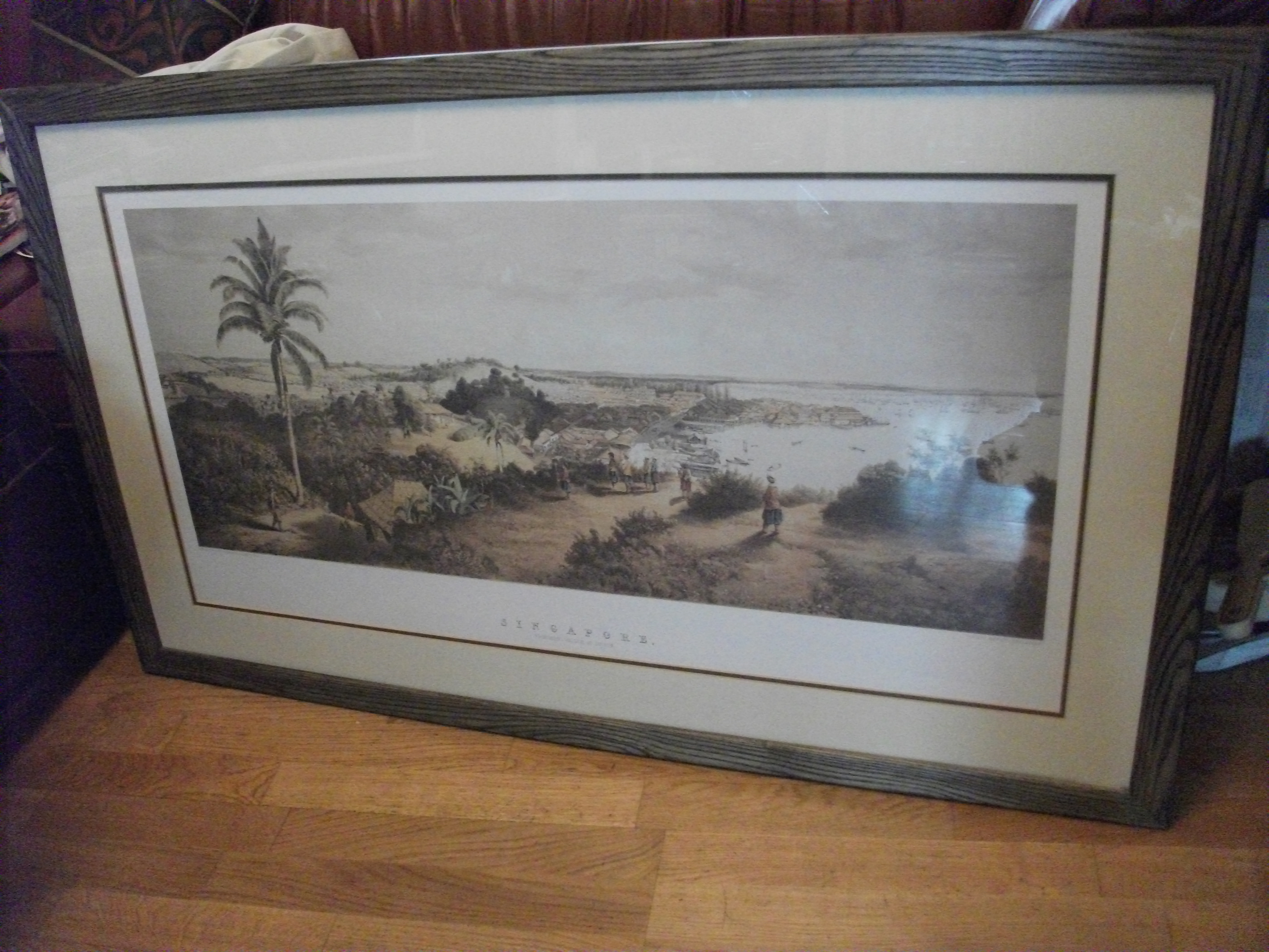

I've just done this one in Ash with Liberon Black wax:
It looks a bit too brown in the pictures but it seems to match the character of the print pretty well.
This is the reframe mentioned in another recent thread, the 6 Kg jobbie that fell off the wall after one of the 9mm screws wrenched out.
