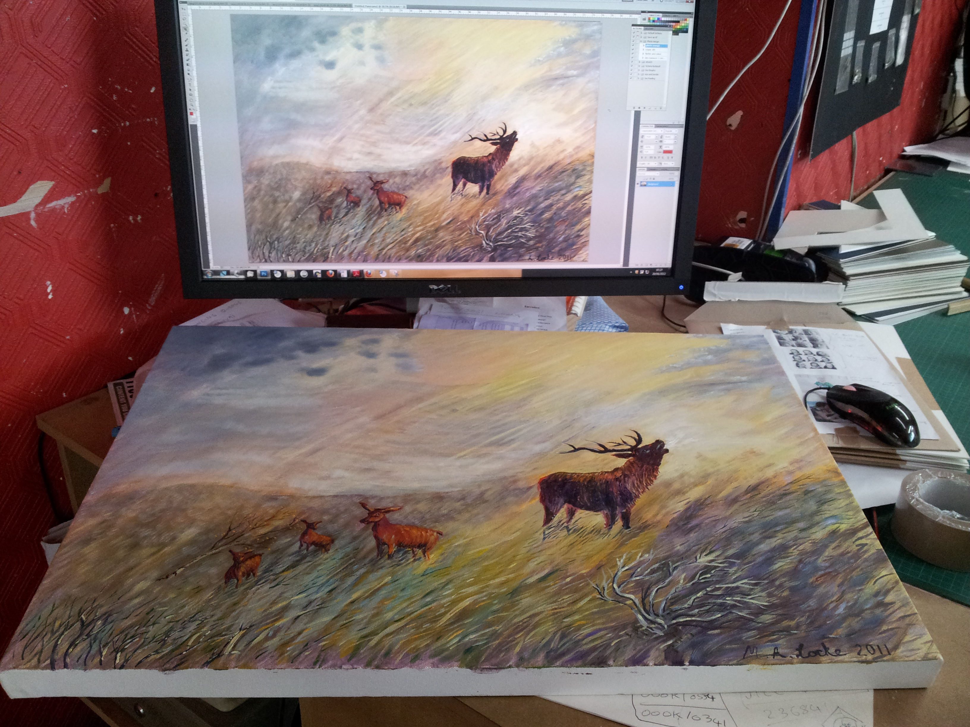

I am about to scan a a 30 x 20 canvas with my A3 epson scanner bought reconditioned on ebay for £285, and calibrated with my I1 proof.

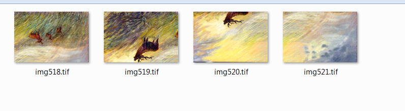

Re: Printing and framers
the 4 scans, scanned at 300 dpi, we can go much higher if necessary. I will chuck these in photo shop now.

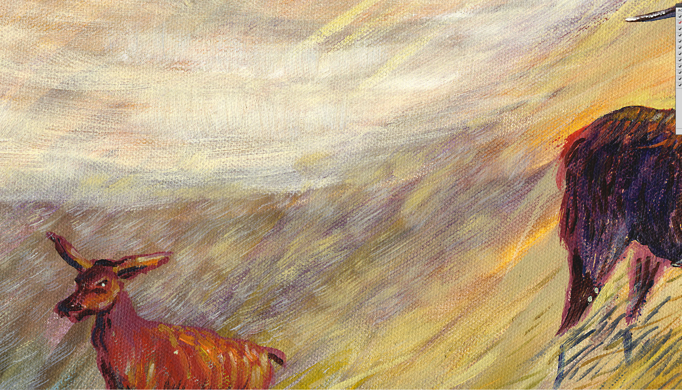

so have put then in photo shop, I have photo merge set as a action because I use it a lot, you need so leave about a 2" overlap on the scans and the must all be scanned straight.
