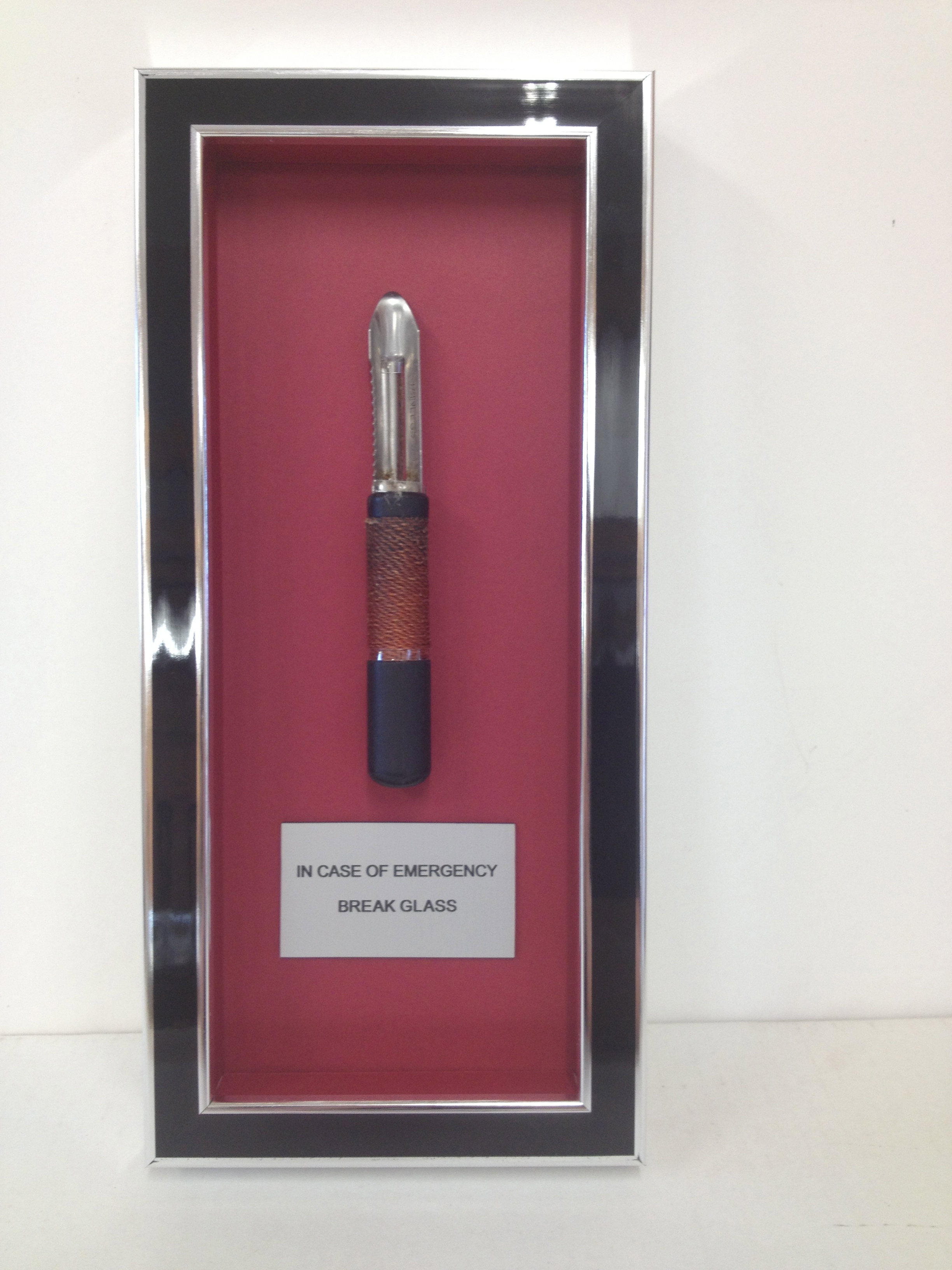

I agree with Steve (stcstc) that Mylar straps would do it. Photo shows potato peeler we had to frame. Spot the mylar
- IMG_2134.jpg (1.74 MiB) Viewed 6082 times
