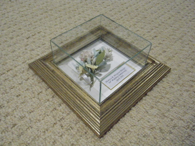

I had earlier tried constructing a glass box with silicone but found the finish
to be a diffucult process and of poor quality.In that case, I was joining the
glass edges - corner to corner leaving 2 exposed glass edges
(thickness of glass) forming a triangle to fill with silicone.
I received a bottle of Nano470 (construction / high viscosity) and set to work. It requires that the glass sides
are joined by a butt joint. I suceeded in making a few boxes and with the practice
and improving the techniques as I went, I was certainly getting an acceptable result.
The biggest issue is cutting the glass accurately enough so great care must be taken
at that. When you're cutting a glass sheet for a picture frame you will have
the luxury of a 2-3 mm clearance with the moulding - with this you have to be spot
on as this process requires only a thin film of glue in the butt joint and it will
not provide any "filling" properties.
Another issue is cleaning the glass after the joint has cured. I email nano470 on
this and they advised by return to use 000 grade steel wool - I ended up using
a syntecic kitchen scouring pad which worked fine. While the thin film of glue in the
joint sets solid , the overspill stays guey for much longer.
First attempt with Nano470
Part of my interest in this is to use up regular 2mm glass offcuts, so where
possible I'll stick to that. It is generally recommended to use 3mm glass for
this purpose and I guess the thicker the glass the easier it would be to work
with. So for now I'm just using regular 2mm cut on fletcher wall cutter. Once
the box is completly assembled,rubbing over the corners / edges with glass pad
knock off any sharp edges and leaves a good finish.
Wall mounted frame with protruding box
I also suceeded in assembly a glass box with lips (retained
by moulding rabbet) to give a regular wall mounted frame but with protruding
glass box (might be good alternate to shadow box for some items)
So, while the end result is not totally perfect, with practice it would certainly
improve and I believe would be very satisfactory for many framers.

Wow, this thread revived again :)
Good, can show you all a couple of display cases made from 4.38mm Artglass UV :) :)
Dermots link to an pld flyer on the last page is obsolete, best now to go to the glass display cases page here http://www.tudorglass.com.au/products/g ... cases.html
See the pics a couple down, starts with an empty case (artglass) then the second shows that with ballerina statue inside . . . following pics show footy cases made in 6.38mm lam, and Artglass Protect 4.38mm lam, with bubble wrap in front easy to see the benefits of almost no reflection.
Also note the much less visible edge in thickness and a cleaner / whiter edge on the Protect.
Other case pics on the gallery page.
