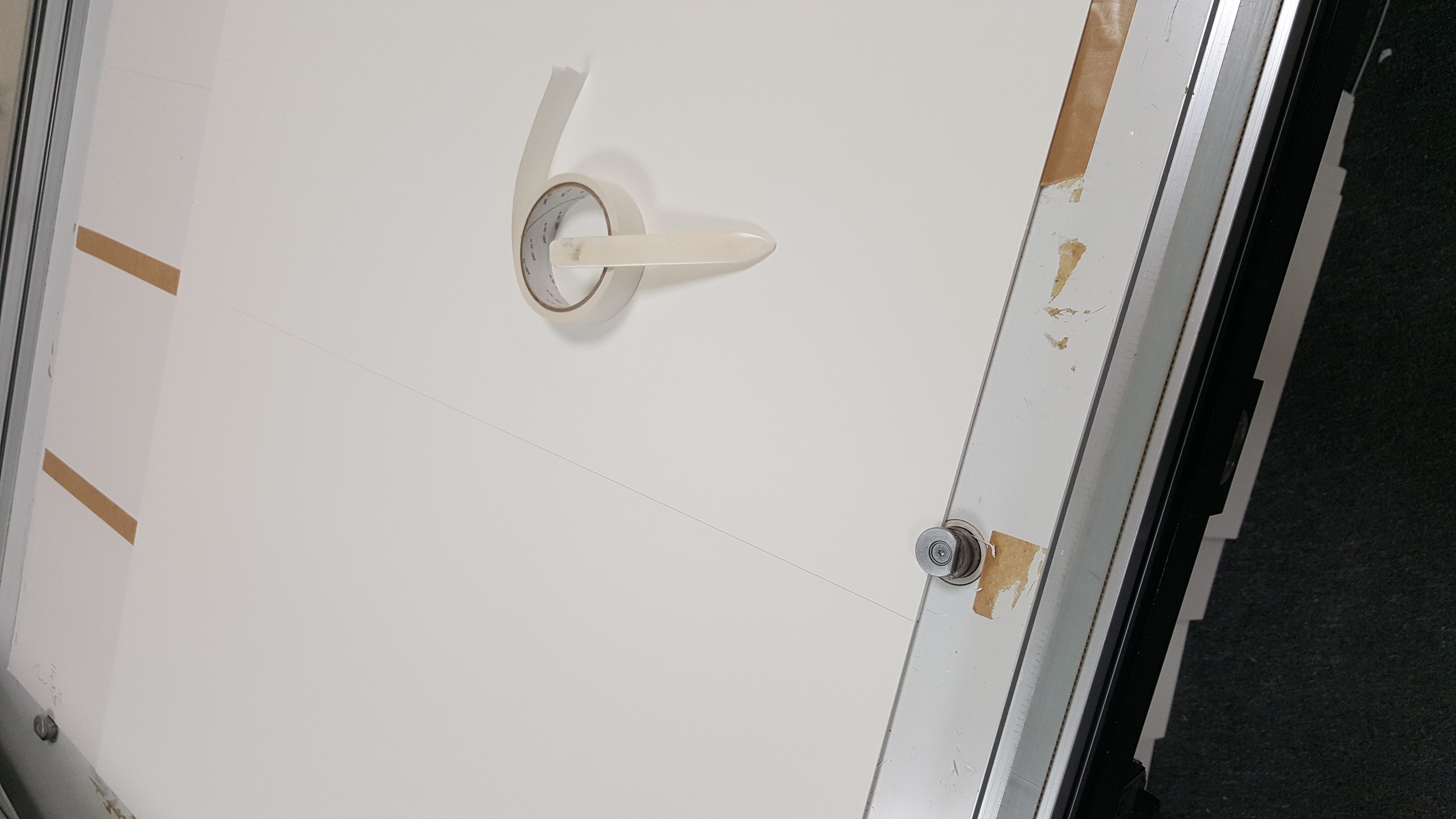

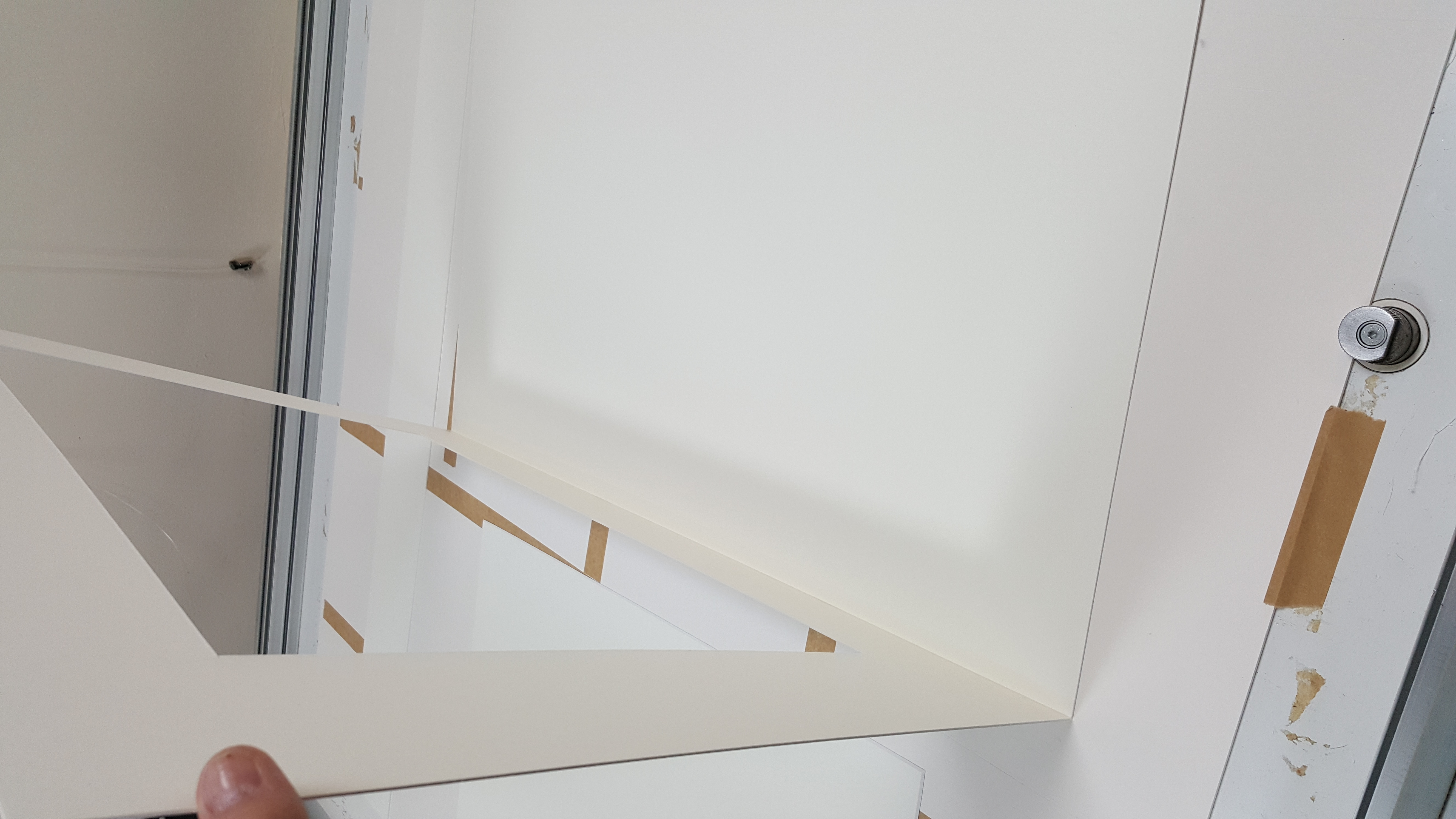

So rather that just comment on this I will offer our method up, feel absolutely free to critique or point and laugh, I am a big boy and can take it.
Where possible we cut the under mount and mount out of the same card and we join the twi togetger well still in situ on the Mount cutter bed, clamps / vacuum on so theres no movement.
Whether we ccut the aperture first or the outside Edge first just depends which Head is On The Mount cutter as we have a vacuum on machine this doesn't really matter. Once this is cutt and joined the accurately cut edges, tight butt up between the mount and undermount makes positioning folding the thing very very easy indeed.

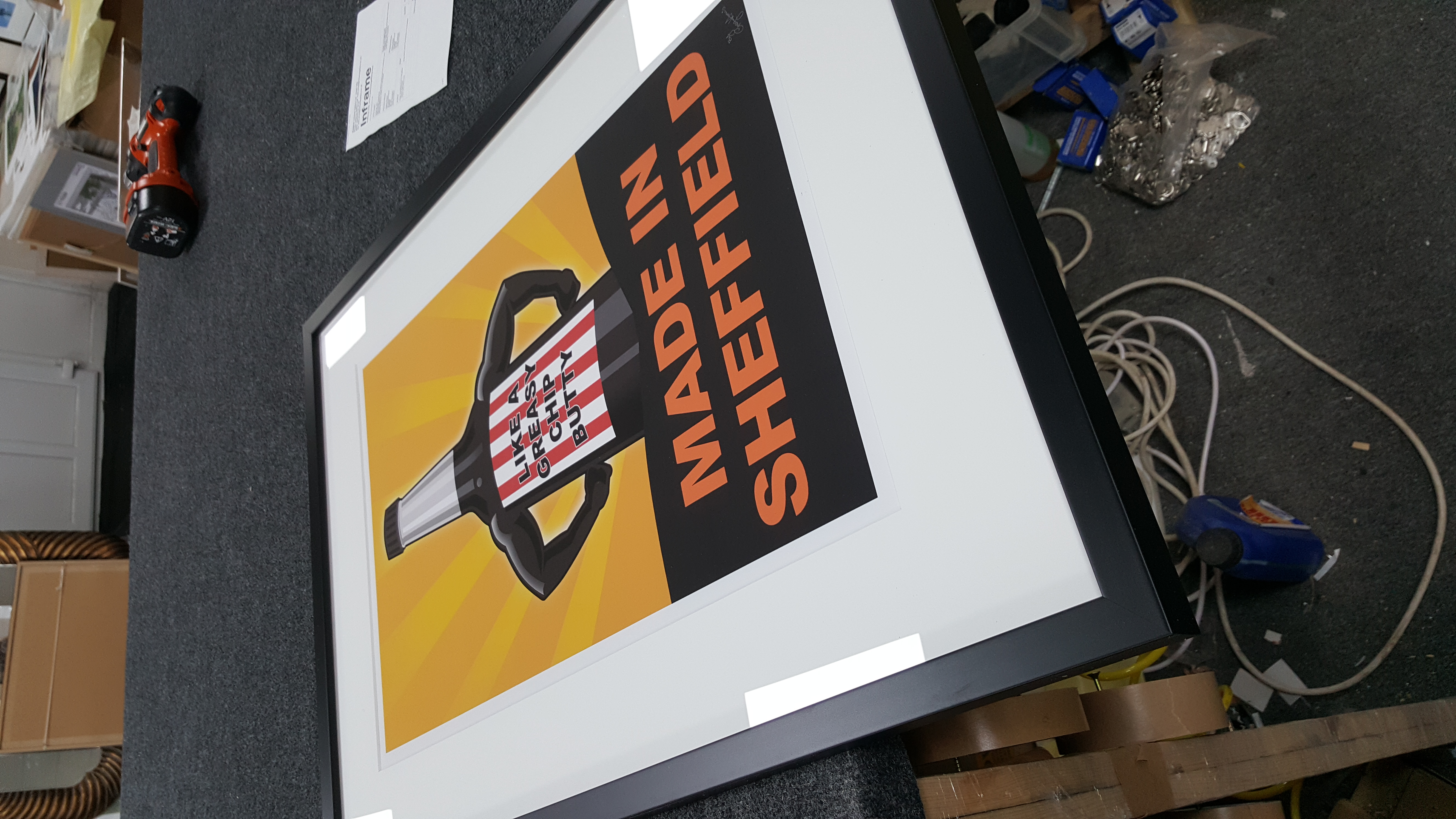

If I was concerned about thin paper being grip too tightly i would put in a spacer around the art work the same thickness as the artwork.
Not finished yet, glass needs cleaning but you get the idea, fast efficient,easy and accurate :D
