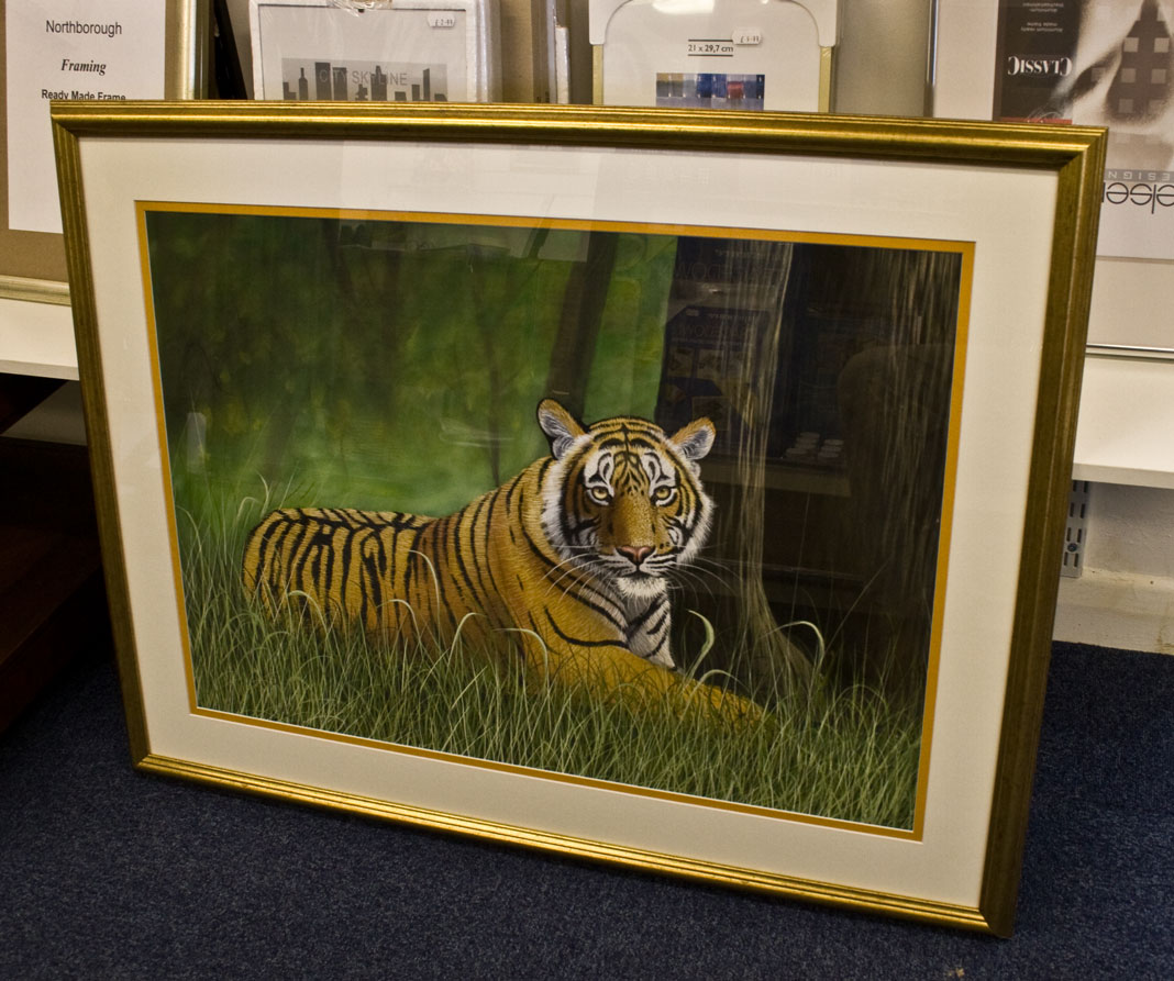

Here is one I did this week using that method.

That is impressive John. (well I'm impressed anyway :giggle: ) And proves it works very well.
Did you find it difficult at any point in the process? Silk is very slippery, isn't it?
