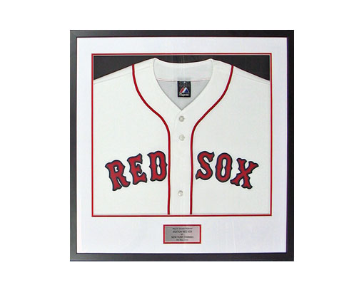

After seeing John M's results with his camera over the bench setup, I thought I would try my camera on the ceiling again, this frame is finished with 2mm float, I'm really pleased with the results, I have daylight tubes in my flourescent lights but no flashes or anything, I think I'll carry on using this, more than adequate for my website I thought. It's so much easier laying it on the bench than trying to hang a black sheet backdrop
I did do a litle 'tweaking' in Photoshop Elements.
Re: Photographing Finished Frames
Time out!
The vertical red stripes aren't central with the title aperture - sort it!
I've turned a corner, I no longer strive for perfection, the customer gets wonky stripes

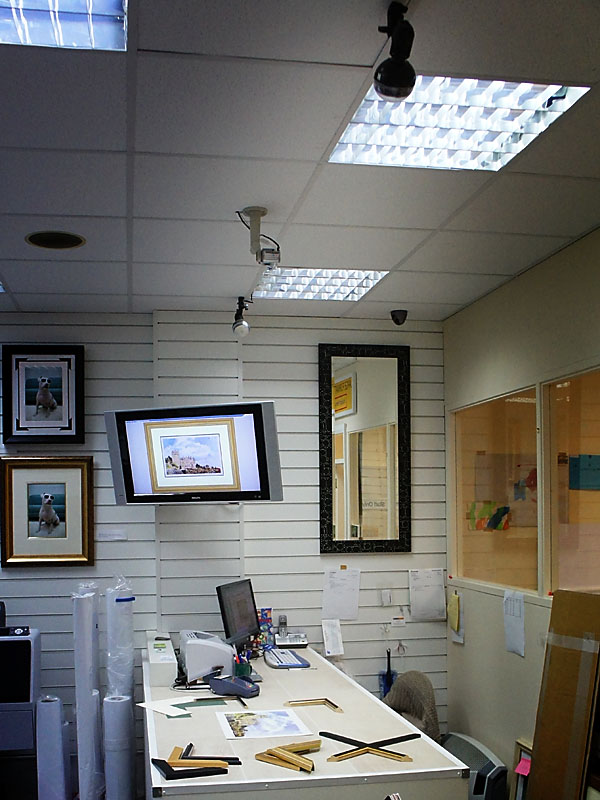

I like the look of this set up to capture images for our website- The results seem brilliant.JohnMcafee wrote:We often photograph framed pictures glazed with normal 2mm float. Two cheap studio strobe units are positioned to illuminate the subject obliquely, and the camera is positioned at a point mid way between.
The glazed picture is placed directly below the camera.
This is the photograph that you see being taken in the above image. Resized, but not re-touched.
I realise John is using Pre View here to capture the image remotely and was wondering if http://www.breezesys.com/PSRemote/index.htm would do the same thing
This piece of software is $95.00 but does use (nearly) obselete Cannon models, but they are available on ebay.. They do offer software for DSLR but both the camera and software are dearer.
Anybody have any views on this software or perhaps know of others?
I would also be grateful as to what sort of lights would be best for this set up?
Thanks in anticipation
Will

Yes Will, BreezeSys will remotely control lots of Canon cameras. But I think, for the average user, probably the only advantage over the software supplied with the camera is its ability to shoot time lapse sequences.
Up until quite recently, Canon supported remote capture in its compact cameras. The last compact models to have this ability being the G10 and the SX110 IS. Plenty of these to be found on eBay.
When looking for a compact camera ensure that it supports what Canon refers to as Remote Capture, note that not all early Canon compact cameras support remote control. Contact me if you have any doubts about a model's suitability.
The very early cameras were supplied with an application called RemoteCapture, but latterly this was incorporated into a multi-function app called Zoombrowser. Only the more recent versions of the Canon software supplied with their compact cameras will run natively on Windows7, though in most cases, you can download an update from the Canon Site. When buying a Canon compact make sure that you get the CD with the driver software as this is not available on-line, only the update.
If you are sticking a camera on your ceiling either permanently or semi-permanently, you will have to use a power adaptor, otherwise you will be constantly replacing batteries. Some of the early G-model cameras were supplied with this accessory, but with the help of eBay it should not be difficult to obtain one for other models for not a lot of money, but be aware that the adaptors for the Ixus range are more expensive and more fiddly to use than those for the Powershots.
Cameras being operated remotely will probably require one or more USB repeater (rather than extension) cables to transfer the image from camera to computer as the USB signal degrades quite rapidly as cable length increases.
If you want to go the EOS route there will be no software driver problems and the latest models support remote capture. However the camera will have to be operated at a fixed focal length.

A 10m USB repeater is only around £7 or £8 - and if that's not enough two or more can be linked.
The Canon A620 camera that we currently use was introduced by Canon in 2005. Ours was used for general family snapping before being attached to the ceiling above our counter nearly three years ago where it has been left permanently swiched on ever since. It is used many times a day, and has never let us down. However we have a spare SX100, which has a much faster response time, a greater optical zoom range, and more pixels, waiting in the wings, but for our purpose, even this is overkill.

Thanks for that John, just to clarify, are you saying that I can operate a Canon powershot remotely without this software? I want to be able to zoom in and out etc etc
The other thing is what sort of lighting are you using in your set up?

Canon cameras with the Remote Capture capability are supplied with software that lets you control them from your computer keyboard. Most, but not all, of the camera’s functions are supported, but certainly zoom, white balance, flash, Auto/manual exposure, aperture, shutter speed, and most importantly the shutter release itself.
The strobe units that I use were bought new on eBay, possibly out of China – I don’t remember the details but I think about £20 each. They are too powerful so masks were made from mountboard (with a half inch hole cut out) that fit behind the screw-on lenses.
The camera that I use has no external flash connector, so the strobes are triggered by deflecting the light from the camera’s on-board flash using a piece of tinfoil. This also prevents the light from the camera’s flash from falling on the subject.
