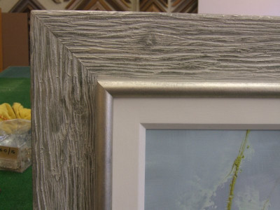

A bit of 'groovy' pine with a hockey-stick section added to form the rebate.
The random grooves were done with a Dremel+sanding drum. Great fun. :clap:

I am really impressed with that. I don't actually know if I have enough manual dexterity left in my right hand still to attempt something like that. I still have a right handed brain, but it was the right hand side of my body which was damaged by the stroke, so maybe not! Sorry, but I was about to send a replay to your previous post when my internet provider phone to fix my email.
