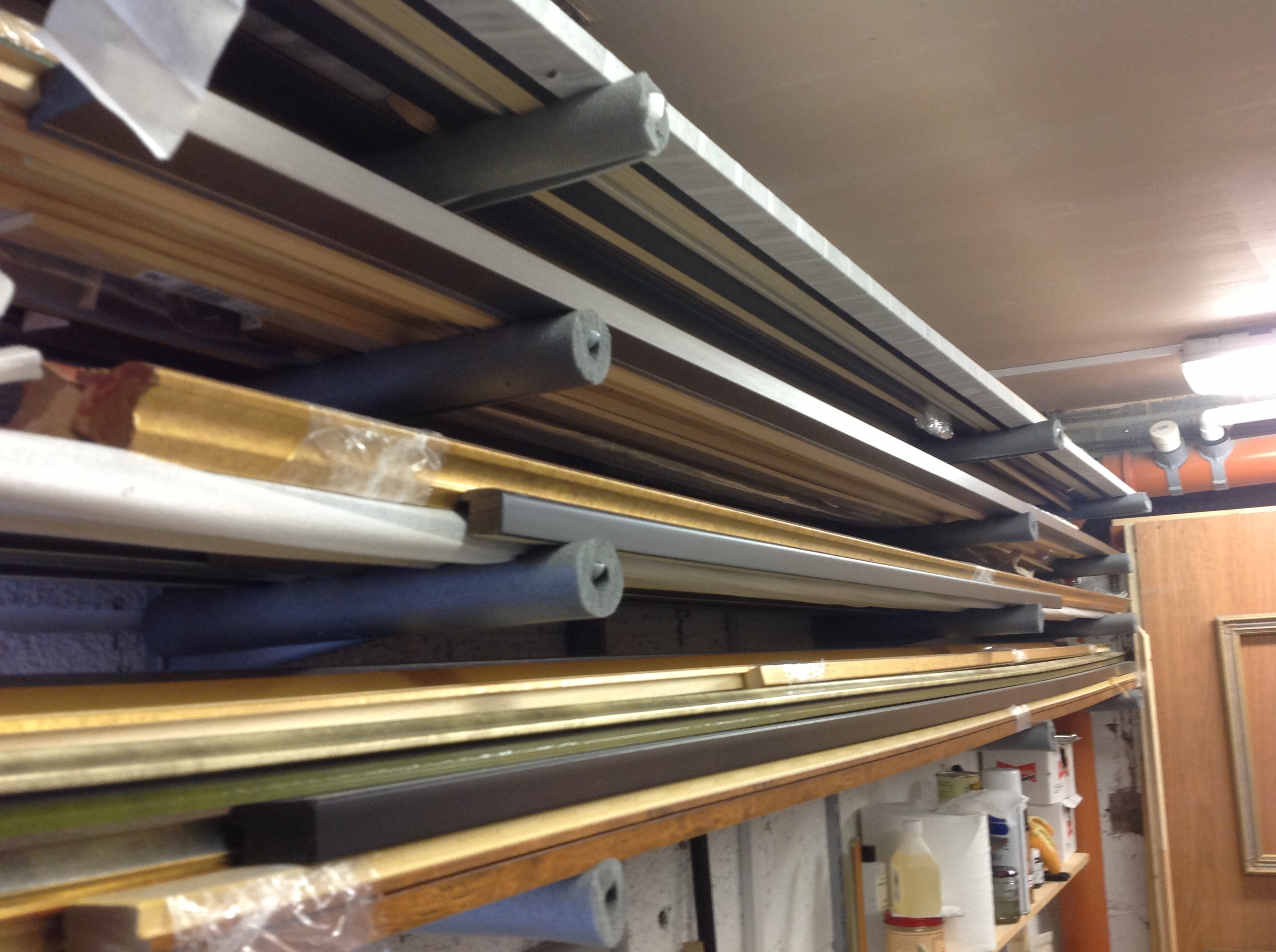

These are mine:
http://theframersforum.com/viewtopic.php?f=6&t=8396
You can just see them above the bench, I would take a new photo, but camera is dying. Lion also do some.
Ive got three of these on the same wall, in total over 200 lengths of moulding, hasn't come down yet.
Dave

We just put our moulding brackets up - used sets of 3 (per row) 12x14" London Brackets, with the 14" being used for the moulding to rest on. With foam pipe insulation covering each bracket. Safe as houses, and only cost about £30 all in! Win win if you ask me.

B&Q shelving brackets wrapped in that copper pipe foam insulation. Nothing has fallen off, yet, but I do need to add some sort of fixing to stop moulding falling.
