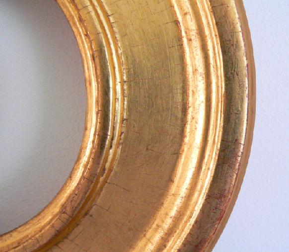

The frame was treated in the same manner as any water gilded frame. The gold was left quite bright with the distressing, cracking of the finished surface, being a dominant feature. Side of the frame were ochred as usual.

circular (Rondo) frame made with the router.

I must say, that is very impressive!!! How long, with all the processes, does it take until it's looking like that?

Hi There,
The frame itself is constructed in two sections, composite board base with softwood laminated on top.
The routing of the disc, then the moulding itself is the quickest and easiest part. I have constructed jig's for doing circles. arch tops etc.
The finish, in particular the fine cracking, did take quite a bit of time.
The soft light tone I achieved with a thin coloured size.
Pleased with the end result of this one.
thanks for your comments

Sorry, but I forgot to mention how long this was to do from start to completion.
Was approximately, 4hrs.
