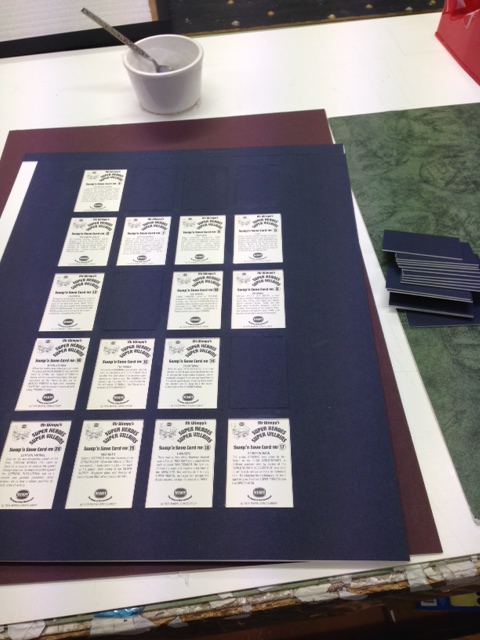

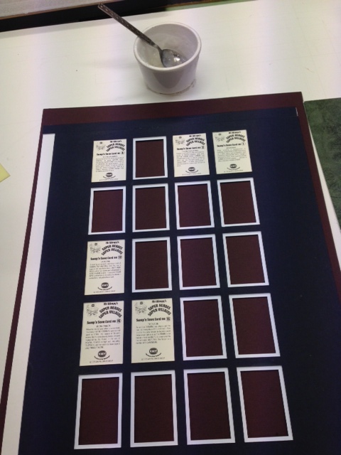

This is the back of the mount - looking at an under-mount but with 90 degree cut apertures half a mil larger than the cards. Pasted to the back of the multi-aperture mount with freshly nuked starch paste. The paste goes RIGHT to the edge of each 90 degree cut aperture (dark board) Cards simply dropped in once dry.

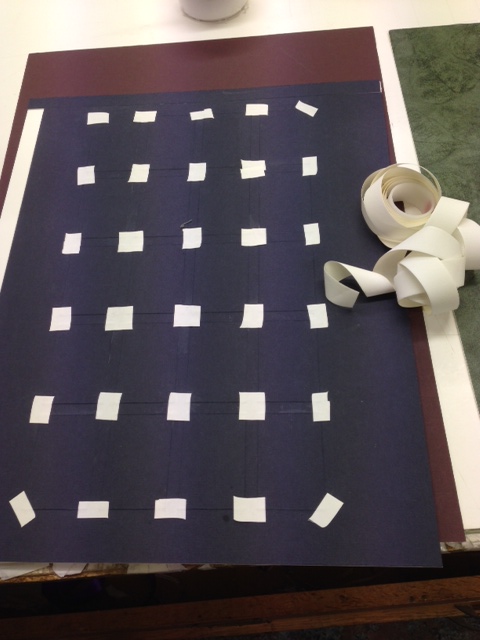

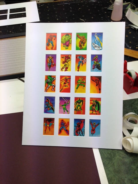

Fall outs placed back in and taped over the corners with gummed linen tape Front - doesn't look any different to how it would if they were hinged or stuck down - but no adhesive whatsoever and a piece of cake with a CMC - tricky without one, but do-able.

Very nice Roboframer. Is it necessary to secure the two mountboards together before putting the cards in?
Re: Multi ap platform mount
Absolutely - and right up to the apertures too, to prevent the cards (or whatever) slipping between front and back apertures. The two mounts are one.
