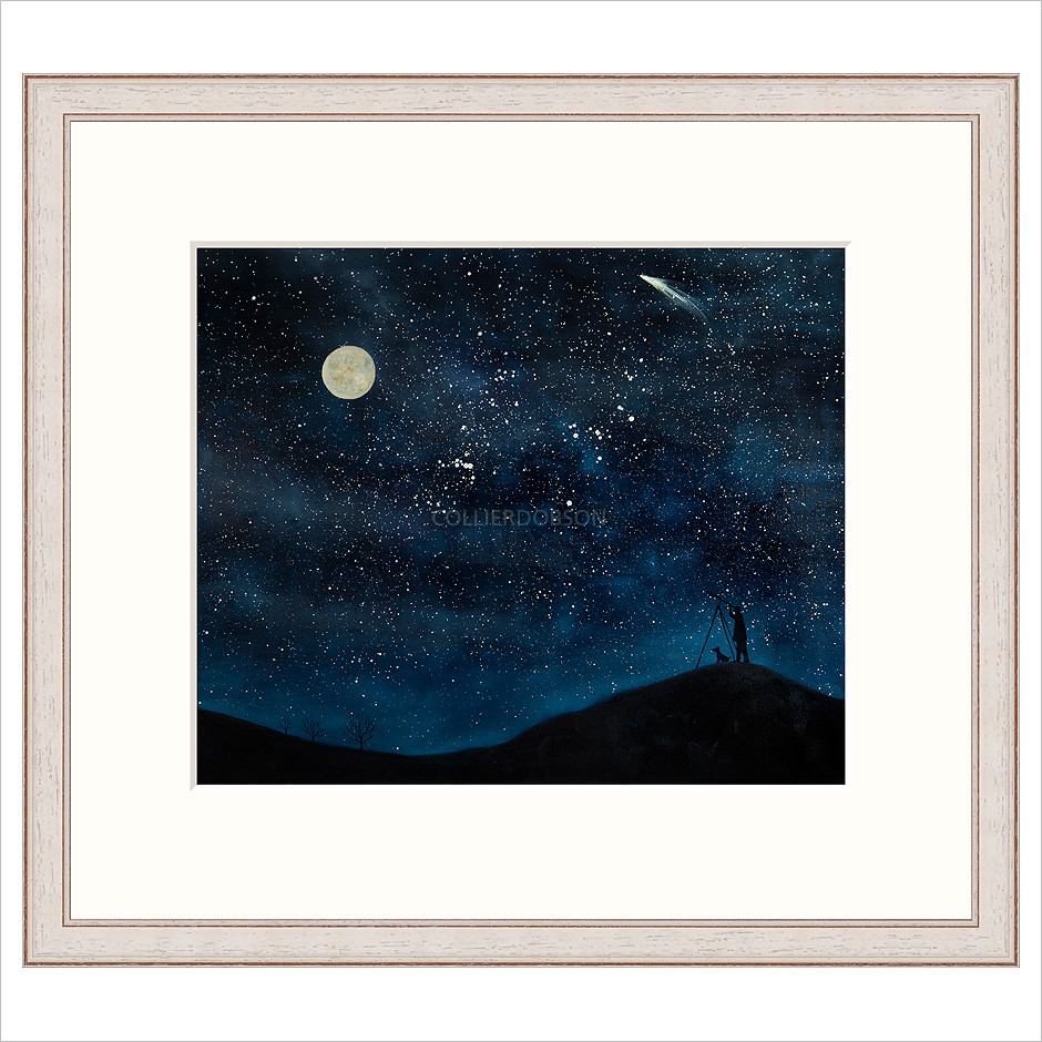

Here's how the publisher of this limited edition print sells it mounted and framed

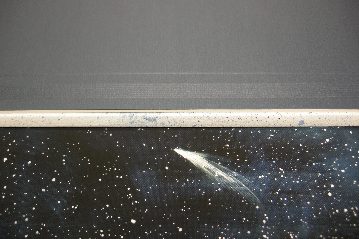

The one showing the complete frame is closest to the mount colour, which is a metallic artcare board 'blue tanzanite'.
The deep bevel is made from strips of artcare foam board wrapped with surface paper peeled off mount board offcuts and stippled with paint flicked off a tooth brush, prior. Just thought I'd do the reverse of the sky to see what that might look like and decided I liked it.
Set of 7 or 8 CMC-embossed lines 1 mm apart then another one 5mm out.
Moulding is from L Juhl's 'Fenice' range. http://www.arqadia.co.uk/productdetails ... mno=464500

Personally I prefer something along the lines of the original, perhaps using a French or Peploe mount. I think the frame is too much for the image and the colour of the mount just doesn't harmonise with the image, it competes with it. Just my personal taste.

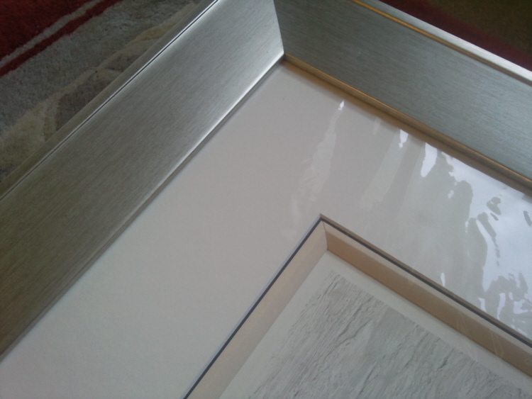

I do have off white moments - these prints are from the same order.

now you have a much fairer view of the 2, I used the picture from your one and it is unaltered.
Geoff
Re: Off white?
two mounts styles. The French mount has a slight umber wash
