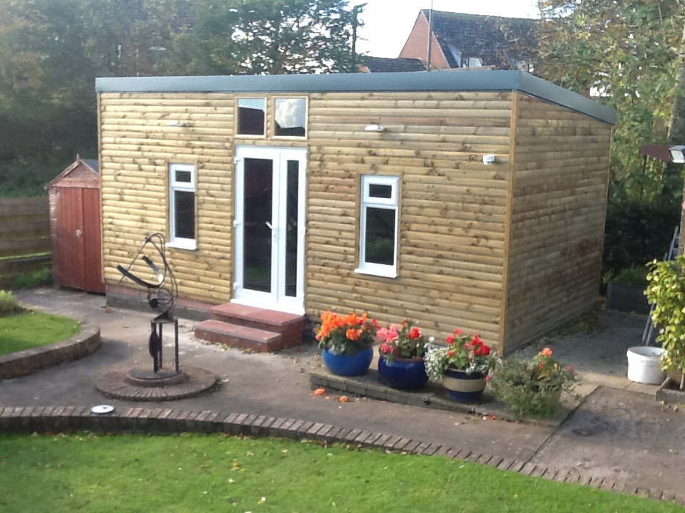

Hi Deepjoy here is a picture of one i had made to my spec with double glazed windows let me know if you want any further info,
- IMG_1341.JPG (86.44 KiB) Viewed 17802 times
Dave

That is SERIOUS!!

That's nice!
I want a mother of a cabin. - The one I am looking at is 70mm walls, double roof with Kingspan insulation between roof and foor, 6M long x 4M wide, 2.5M high at the eaves and 3.6M at the roof centre ridge. I just need to plan it out correctly to make sure I get everything in in an ergonomic layout.
