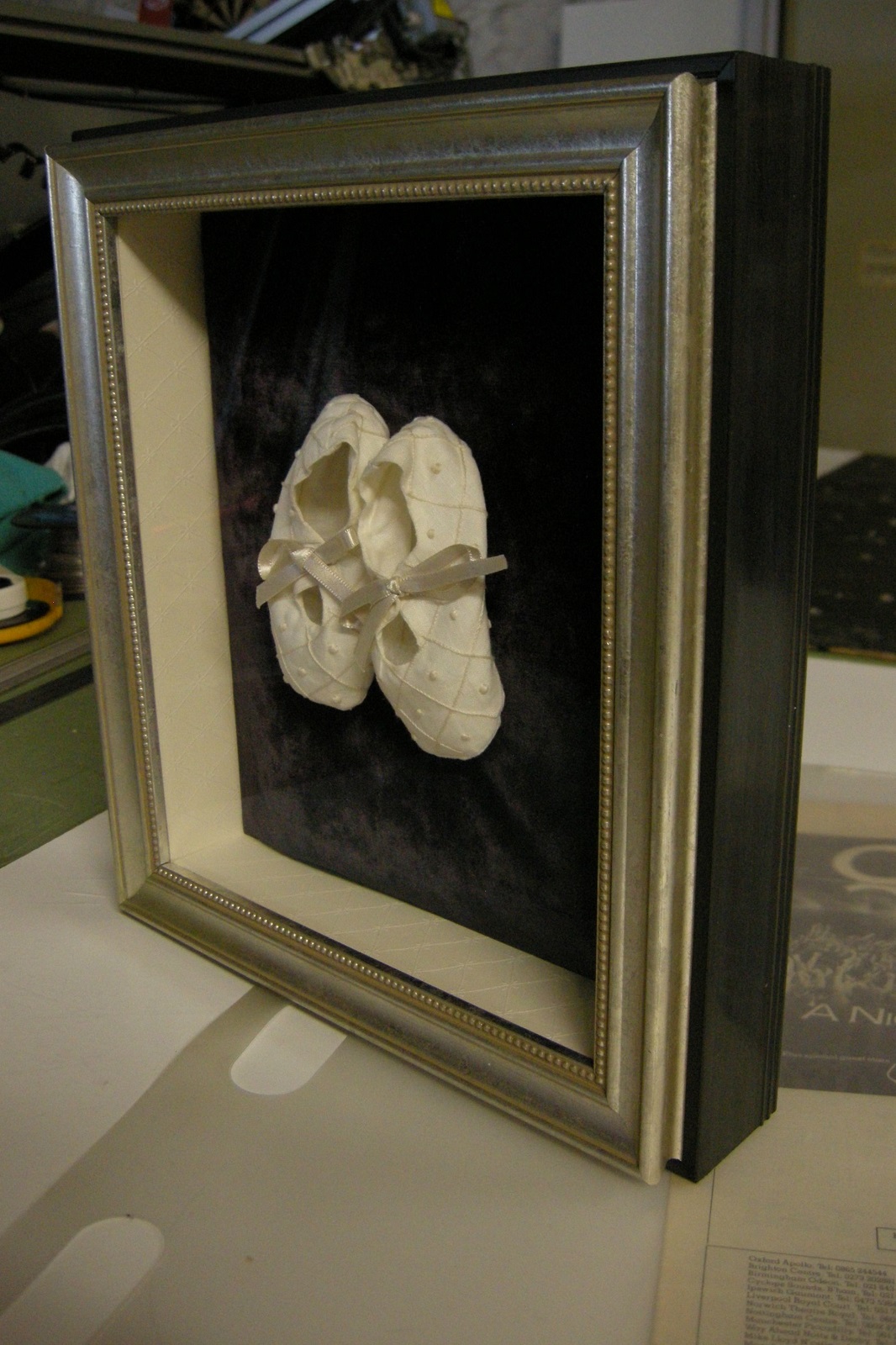

Well, booties!
Bought these in Madeira, just to frame up as a prop, they're pretty shapeless but that's fine.
The backing is plum velvet (we sell it) padded with 4 or 5 thicknesses of 2 oz polyester wadding (which we also sell) I tagged it in a small central circle to create a sunken centre and make the booties (they're a bit too delicate to be booties I suppose - slippers maybe?) look like they're sunken in - a 'pillow' effect. They are stitched in place, very delicately.
Rebate spacers are lined with a long-discontinued artcare board we still have stock of - matches the pattern.
Box is made from http://www.arqadia.co.uk/productdetails ... =204230267 and capped with a Simons moulding I don't have the ref of handy.
It's a bit twee but it'll bring work in.

Mmmmm, I like that! I must admit that before I saw this I would not have natuarally thought of using the black moulding with the silver, but having seen it, I really like the result.
I love the more traditional silver mouldings with a nice bit of shape to them and for me that silver moulding is just perfect for that lovely pair of shoes. It would almost pass as an old family hairloom. Give it a few years to fade a little, soften and the frame to mellow and it would probably pass for something quite a bit older.
A great prop for inspiring the customers and as usual something to inspire the rest of us!

The moulding used for the box isn't black, Arqadia describe it as 'pewter' but it's actually a metallic blue/grey.

Looks good John, how have you joined the mouldings?
Re: Putting the boot in
Post by Roboframer »
They're glued together, it's not a big frame and there's plenty of contact area.

Metallic blue grey sounds nice. Your choice of the subject matter to frame is also spot on. I reckon that it's sure to attract plenty of attention.

Just realised to take the photo I stood it on a customer's artwork - OK it's in a folder (a 'visifile'), but still!
I put it in the window and it's already won one job and a lot of interest.
