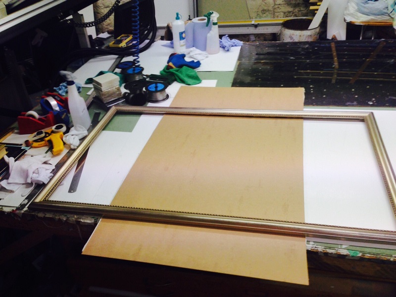

Re: Landscape or portrait?
Post by Roboframer »
This thread made me try doing things differently. This is supposed to be landscape but I measured the long side first instead of the short side and then I thought I'd try joining the frame with the long sides on the right - LOOK WHAT HAPPENED!!!
Now what am I supposed to do? This is due tomorrow and customer is not answering the phone!
Smithy
Posts: 133
Joined: Mon 12 Jan, 2015 7:36 pm
Location: Surrey
Organisation: None
Interests: Reading, gardening, music.
Post by Smithy »
Quadruple mount?
