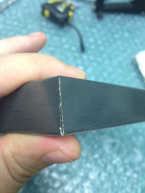

So i need new blades for my Morso. My current ones even freshly sharpened cause the slightest frey/flaking/chipping of the side cut and even times noticed a arch in the side cut
The Framers corner own brand are 150 and the Morso branded blades are 190. Are Morso better (most likely yes) and are they 40 pound better? Also any other suggestions would be greatly appreciated.

I think you need a different moulding. :lol:
Seriously though some mouldings will chip on a guillotine whatever blades you use. It's the brittle coating. They are more cooperative with a (good) saw.
One thing you might try is to place a piece of scrap MDF or hardboard on the fences to hold the moulding away a little. This gives a bit more support to the back. It may or may not make a difference. You might have to allow for it when setting the measuring stops.....

Ye i had thought that might make a difference. i was going to use mount board. Still think the blades need changing too, as they might be helping the chipping

Why do you think the blades need changing? As long as they are sharpened properly each time then they should be as good as new each time you put on a sharp set unless they have been badly sharpened. I had a set that got down to the braze line and were still fine ... until the braze gave way and they went ping.
I think it is more likely to do with the moulding, but check that the blades are fitted correctly and lining up. I have had blades that have been sharpened badly that had different amounts of grind on them and they had worn differently which caused problems on the cut.

thats the problem, i got the morso secondhand so even though i got the blades sharpened by a framig company (act as a middleman) I dont know how they were done before me

Do they cut fine on other mouldings?
As long as they are hollow ground now I would say they would be fine. That definitely looks like the moulding to me.

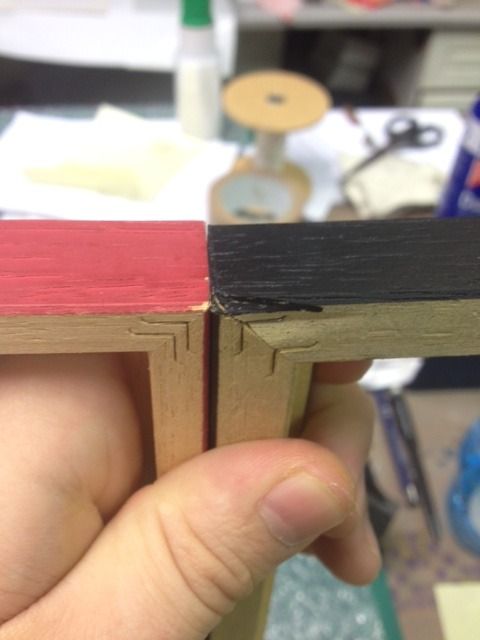

Ye they cut fine on others, I did notice on cheap mouldings they will pull the bottom of the cut so they become lose and i notice when framing the picture.
(the one pictured isn't cheap :( )
I tried colouring the chip on the black rim. The red one isn't too bad

This really is one of those things (just another thing to dampen my mood :giggle: ). I have had similar issues & I've usually blamed the blades - until I take another length of the same moulding and it cuts/joins fine. Then.... just in case the blades are at fault I change them and lo & behold ... well, actually it's either better or it's no different (well I suppose there couldn't really be a 3rd option)

Go ahead and buy a new set having more than a couple of sets is always advantageous in a workshop. However I don't think it will totally solve your problem, Moulding is more of a variable than the sharpening or condition of the blades. Even with a cassese saw I find some mouldings still chip (but not often) I think it is one of those things certain mouldings will always chip on a morso and sometimes even a moulding which is usually good can go bad even half way through a length due to nature of the wood, especially with composite wood which is often used, you can just hit a soft spot or a bit overly hard, thats the nature of the wood.
