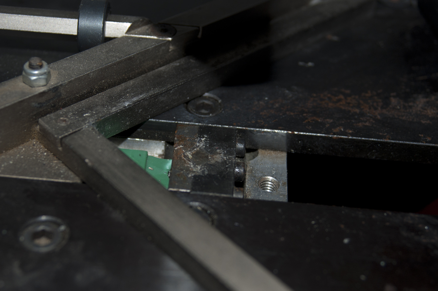

I was wondering if anyone had any advice on how to remove a jammed pin in my underpinner. Its a cassese CS85, i'll try uploading a photo here of the said pin.
Panicking a bit as i have a bunch of framing still to do before christmas!!
Any help much appreicated!

If y o u don't have an instruction manual you can probably download a copy from casesses website, I had a jammed nail last week (casesse 1) and it was very easy to remove the block once I had the instructions.
Re: Jammed pin in cassese CS85
Thought I had replied to this yesterday but obviously didn't posr it.
What you need to do is remove the block. There should be s small Alan key screw on the side of it to remove it. Yhe block should lift out. Once it is out there are 4 more alan key screws which will release the block in half thus allowing you to clear the blockage. When you have done this put it back together applying a tiny amount of grease to the inside of the bock first. Once you have done this you need to slot the block back over the hammer pin. It's worth checking the hammer pin for damage as well they can split. Once you get the block back in place level it off with the base plate and tighten up the Alan screw. Jobs a good un .

I had this issue in a CS88.
Every so often one would jam and I had to do what Grays describes.
In the end I had to get a new firing pin as it was buckled.
