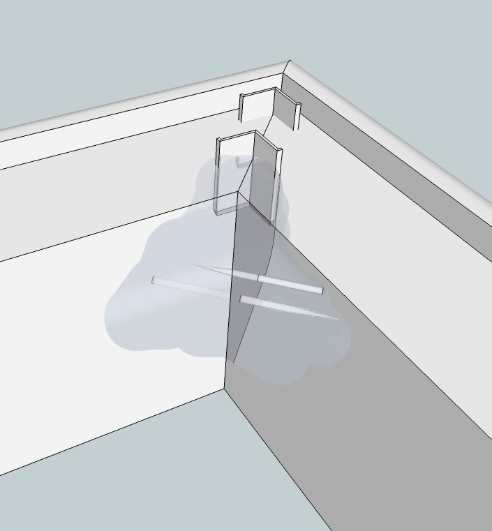

I used to do a joint similar to this but many years ago. It involved driving long wedges up into the back of the rebate, perhaps two spaced across the face, then using a pin punch to complete the insertion of the wedge into the moulding. I discovered that pin punches were counter sunk, having bought my first in the early 1960's. This actually locked onto the elbow of the wedge so the pin punch stayed in place whilst light, drumming taps drove the wedge into the back of the rebate. A couple of extra mm's depth is useful.
From this technique I developed a jig, this made it possible to drill into the face of the mitre a blind hole at right angles to the face of the mitre. This was before the ready availability of the 'Dremel' type hand drills, I had equipped my workshop with dental suspension drills. Using a drill that matched the diameter of a toothpick, mirror image holes were places in the moulding where the 15mm wedges could not reach. By using parts of tooth picks in a way that biscuit joints are effective it is possible to make a blind joint of considerable strength, using the flexibility of tooth-picks.
This may not help the OP, but if it is wanted I could spend some time making some images to show this technique.

Re: Joining mouldings cut on side
Purely by coincidence I was researching a tutorial on Sketchup and these videos were close by;
https://www.youtube.com/watch?v=donBPcmhUMA
https://www.youtube.com/watch?v=oEgRWSqkoXI
How technology has advanced, had I had the benefit of the internet when I made the joint I described in my previous post, I might have used a much cruder punch that a pin punch, one a simple piece of 10 -12 mm mild steel bar with a right and ground on one side.
This would, it appears from the videos above have driven the wedges (or V nails as the google searches would have found) that bit further in, from where my underpinner left them protruding. At the time I did try to chase them in with a second wedge but this was not successful on a consistent basis. My needs were for a joint that was probably going to fail at the upper end of the moulding where the wedges could not reach, so hence the tooth pick/biscuit set up.
These corners never did fail to my knowledge. The drawing is to scale of 15mm wedges in a 1 7/8 moulding.
I described from memory that a jig was made to position the holes for the dowels/tootpicks, it is more accurate to say that two jigs are needed one for each face of the mitre, though they quite simple things to make.
