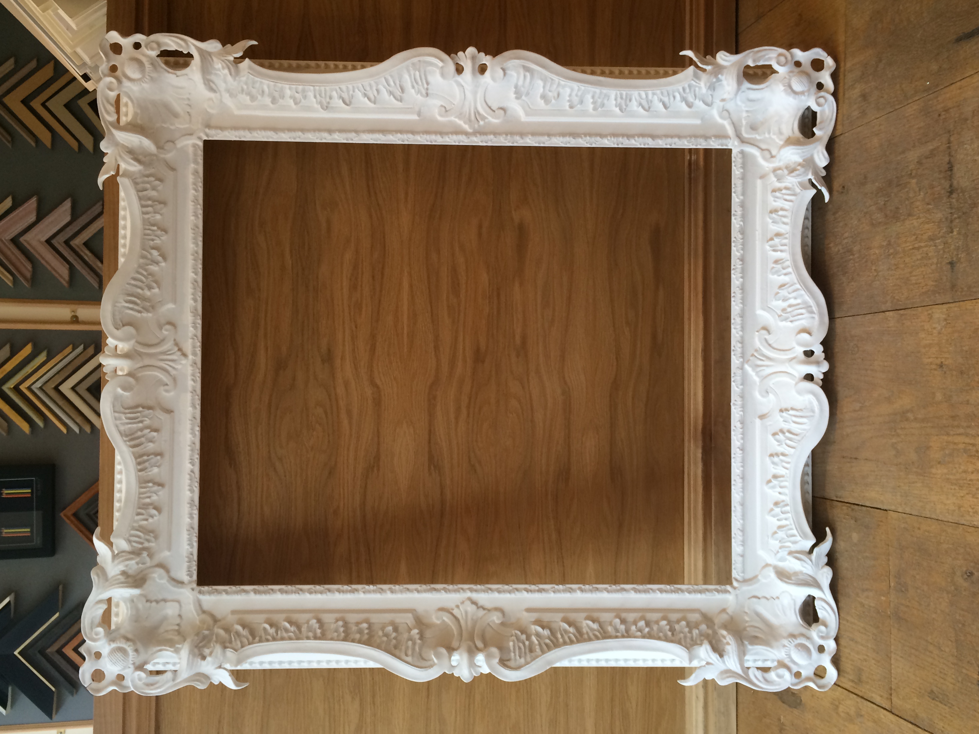

we could look to make an 18th century reproduction
most frames of the 1700's were carved as compo didn't come into use until the end of the 18th century.
depending on the calibre of the painting we can make or source something suitable
this is one we made for a client with an 18th Cent portrait showing both gessoed and the raw gilded finish before toning. sand was placed in the centre panel which was used on some frames.
if this is too ornate, then maybe a British Maratta section may suit. If you google Maratta Frames a few examples come up.
