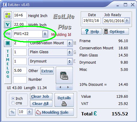

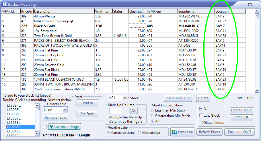

EstLite has a column for Moulding Location (see screenshot below)
However, if you are referring to stacked frames, they are easily accommodated by use of the plus sign. Up to 5 mouldings can be "stacked" in order (Innermost first)
Two mouldings are stacked in the example above, Moulding 22 is the outer frame and PW1 the inner.
Hope this helps.
