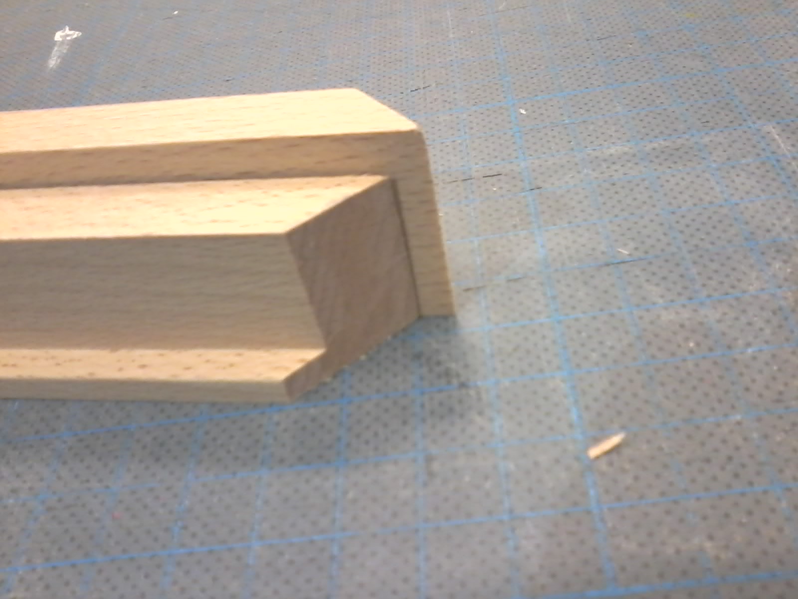

This is nothing to do with defects / damage but come under quality
the same length of moulding , but different depths over the length
over 5mm different, the size of the frame is 116cm so get two out of one length of moulding so the whole length is wasted
