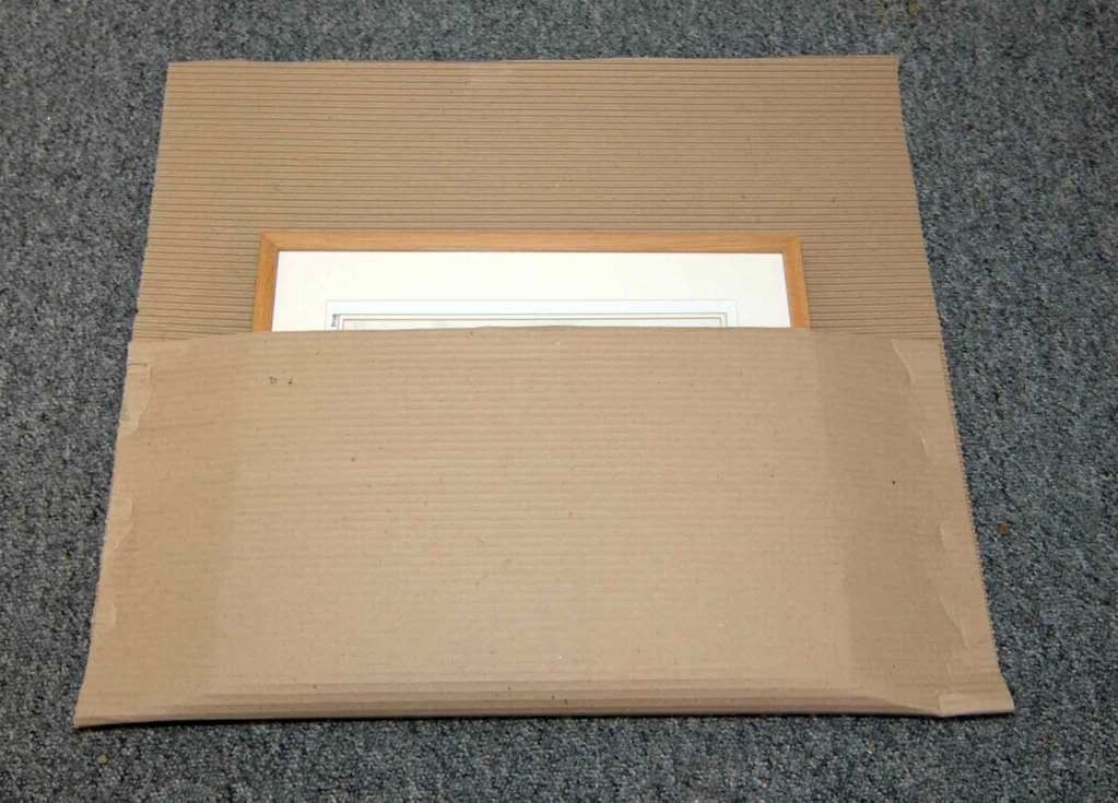

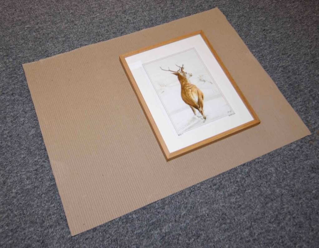

Not sure if anyone is using corrugated roll for packing frames but this method solves a lot of problems in a stroke.
Cut piece 2.5 x height of frame.

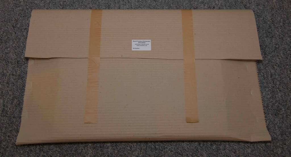

Staple side flaps.
Attach tape to hold flap in place.
Pocket can easily be opened to show customer the work. Flap can also be stapled to complete the pocket. This method offers good protection for the corners and will allow frames to be stacked or placed on edges for transportation. Naturally the corrugated card is recyclable.
A suitable label will also advertise the business.

Ooooooooh! Now that I r-e-a-l-l-y like, Pat! 8)
Now that I've got a bench dedicated to pack 'n' wrap during open hours/handfinished stuff outside gallery hours (note how I'm resigning myself to my unwished-for fate, Prospero et al! :cry: :wink: ) I'm in a better position to look at different packaging options. I've even given my Magik Wand system a permanent home on top of the bench at last!!
Using your wrapping method could be a real timesaver for me. How big is a new roll of corrugated, Pat?

One thing I especially like about your method, Pat, is that you can pack the frame as soon as it's finished, keeping it well-protected prior to collection, and yet it is still really easy to pop it out for the customer to have a look-see before taking it home! Personally, I love seeing the reaction on people's faces when they're really pleased with work one has done, and this packing method really does give one the best of both worlds! :D

Corrugated cardboard would certainly protect a finished frame from bumps etc, but I would be concerned with it scuffing the surface of some finishes.
Cardboard has some abrasive properties that may be detrimental unless separated from the frame by another product, perhaps plastic.
Cardboard is probably best as a form of outer packaging. I'm not too sure I would be using it up against any of my frames!
As far as wrapping a package, then unwrapping it again to show the customer is concerned, I just don't have the time or inclination to be doing anything twice, especially wrapping! Life is way too short and I could be allocating that extra time to another job which I might have more chance of getting paid for!

The way that I now hope to go for average to medium-sized frames is to first shrinkwrap the frame and then put it into the corrugated cardboard "envelope." That should solve the problem of scuff marks (e.g. on lacquer finishes). Also, the shrinkwrap should help with keeping the cardboard fibres off the finished frame. This method should also eliminate the likelihood of the customer pulling bumpers off the back of the frame when they remove the bottom corner protectors.
For me, Ormond, immediately putting the finished frame into a protective package is highly advantageous, since many of my customers are very slow to pick up completed work. It is all too easy to accidentally damage a finished frame while it is sitting around the workshop, and one can end up performing retouches, etc. There have been a couple of occasions where I have had something dent or badly scratch the moulding, and I've had to completely replace the frame rim (costing both time and materials!!).
For the few seconds it would take to pop the frame out of a corrugated cardboard envelope, complete final inspection and allow the customer to view the work, then pop it back in and seal it up for transport would suit me from the perspectives of logistics and business style. Therefore, I think it's time well invested: Both the customer and myself jointly see that the work is completed satisfactorily, and I get to gauge the customer reaction to my work; the latter being important to me from the perspectives of customer satisfaction, personal satisfaction, and to help me to develop confidence in myself as a designer. Also, because the customer pick-up would be speedier (i.e. they are not hanging around waiting for me to wrap it in kraft paper), it will be another way of enhancing the customer's experience of doing business with me.
