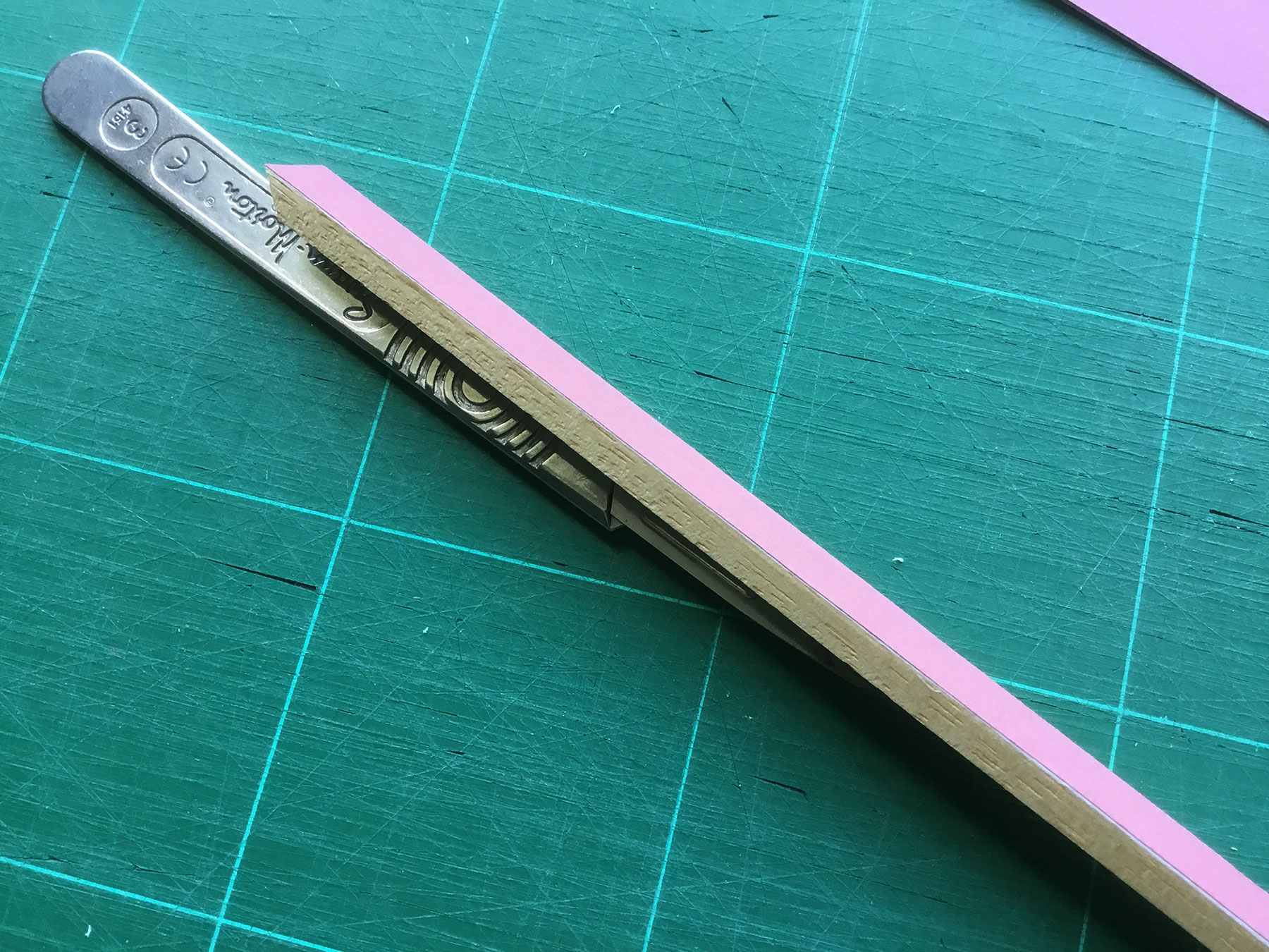

- Posts: 1442
- Location: South Lakes
- Organisation: Framing
- Location: Cumbria
Re: Cutting spacers
I do my spacers almost identically to Steve N except I don't go for a bit sloppy on the fit but rather an easy going slide in fit
I also like to use wood spacers faced with mountboard to match the windowmount. I often strip the face paper of the board so it doesn't show under the glass. The wood spacers in the photo have just the face paper glued on (they're not for the frames in the photo!) Rose & Hollis do a good range of plain obeche spacers.

How do people strip the face paper of mount board, I've never had any success.
- David McCormack
- Posts: 1442
- Location: Cumbria
Re: Cutting spacers
When the frame rebate isn't wide enough to hide the whitecore of the mountboard from showing under the glass, I strip the face paper off. The trick is not to try and remove just the face paper but also some of the layer underneath it too. It can look a little messy but that's ok.
I prefer to use wood spacers. I cut the spacers longer than needed and a strip of mountboard long enough and wide enough to glue all four spacers to it. Weight everything as the glue dries. Trim the spacers with a sharp knife and then trim on the morso to fit in the frame. I mitre my spacers as discussed above. The photos show a single spacer but I would always do four at a time. I did this spacer just for the photos so I cut the paper before the glue was dry so it looks a little rough and the mitres are on the wrong side
Oliver Hardy.
Oliver Hardy.

lovely demonstration, thank you.
