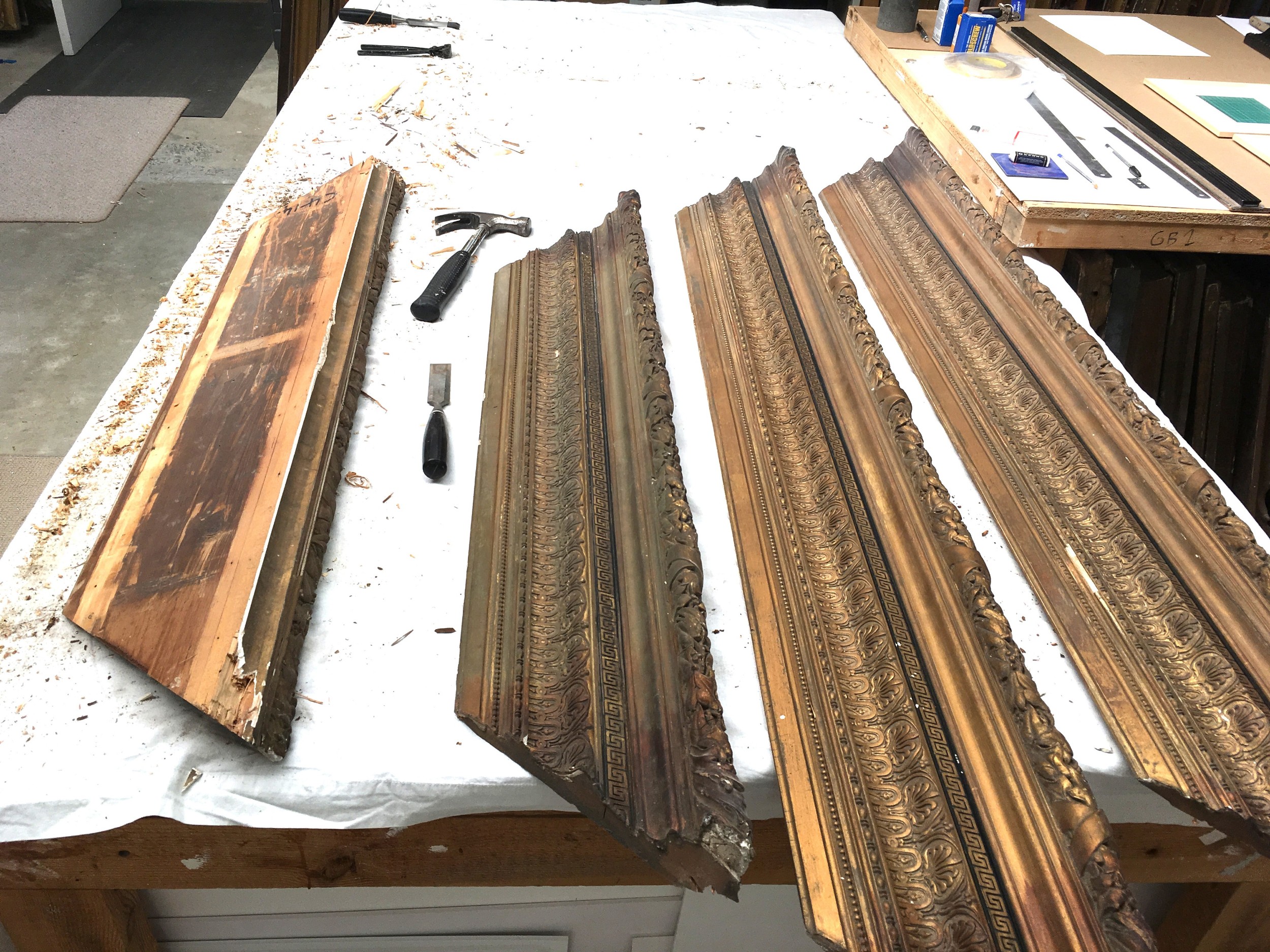

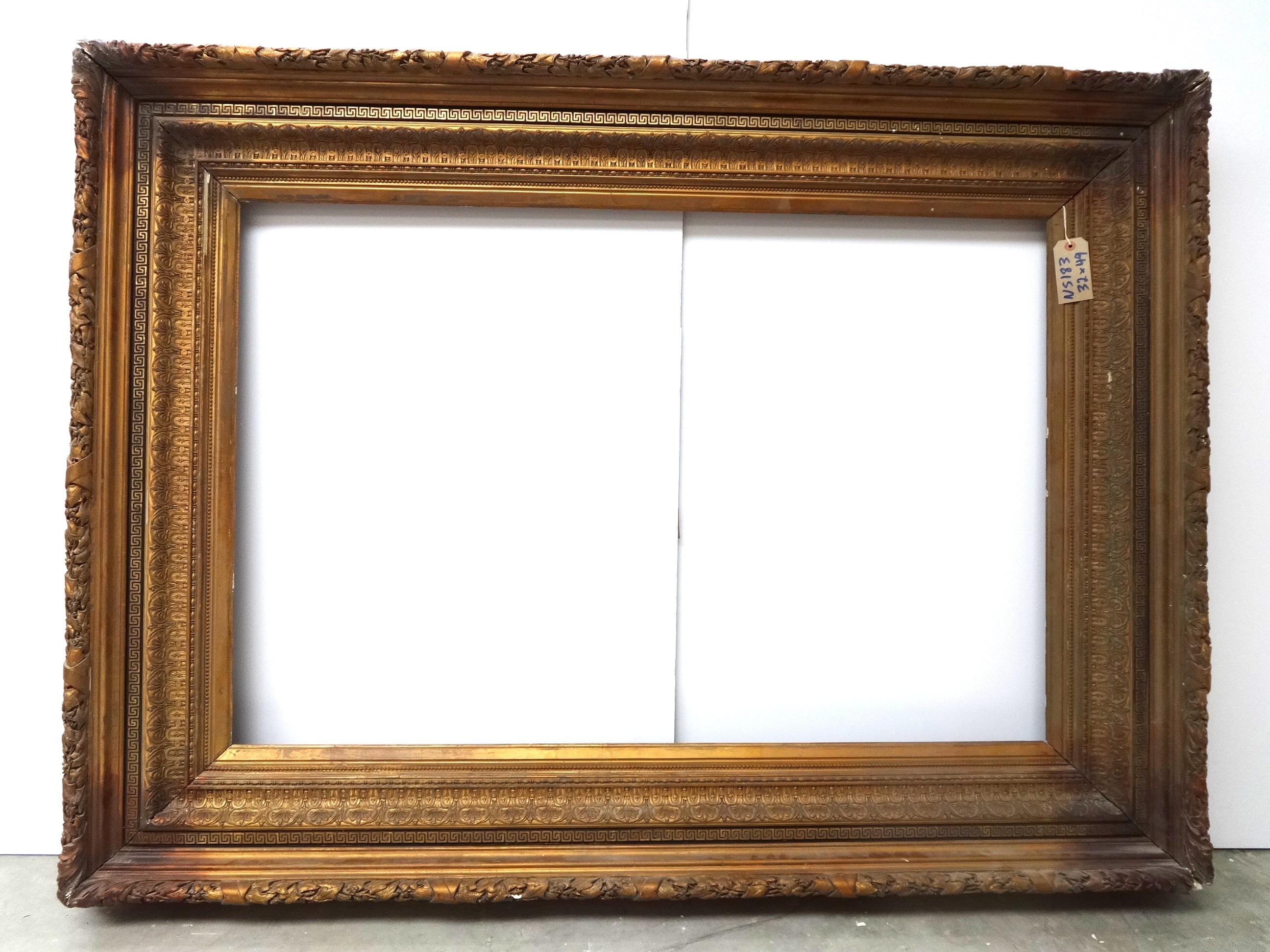

Just started this frame cut down, I've done hundreds of these before, but is always bit nerve racking and also a little sad to change an antique frame size or modify it, but it's something that is done a lot in museums and private collections. I've got another one I'm doing which has already been resized (about 100 years ago), and I am making it smaller again.
This frame is French, late 19th Century. It's being made about 5" smaller each dimension to fit a painting... and also the outer section is being changed, it is currently 8 1/2" wide, some acanthus leaves will be added to the corners and the gilding will be cleaned and regilt in places. Will post a picture when it's done finished.

Lovely job. How is it going to be rejoined?
- Posts: 1431
Re: Resizing a Frame
"With great skill and dexterity"

We used to do a lot of these, predominantly for one customer who trawled auctions for antique frames and the gave me them to chop down and frame is smaller oils - also purchased at auction. Some of the paintings were very old and some quite valuable. I always iked resizing the frames, but was a bit nerve racking. You need some smart equipment too
Over the years I have done plenty of these myself. I don't do as many as I once did, there used to be an auction house in our town which supplied many of these frames and I guess some probably came from charity shops and car boots, well the availability of these frames is not as easy as it once was and lots of nice frames have been given the shabby chic treatment and all to often ruined. Fashions have changed over the years and many people are no longer into nice things with a bit of antiquity.
I still get some to resize and some to repair damage, I don't really promote myself as doing this, but people just come in and ask me if I can do this, or that. I am fortunate to have an original Stanley frames vice, mounted onto a reinforced piece of board as shown in Pete Bingham's book. I did at one time have a couple of large biscuit tins of old bit of compo ornamentation removed from old frames, which I inherited from a retired framer. It his day old and damaged frames were not hard to come by and they were often a ready source of old compo ornamentation. Just about all on this has now gone!
I still like to work on old frames as I like saving old things. If you are thinking about trimming these old frames down to size with a Morso, this is likely to be a bad idea. In the earlier days of my business, I used a Nobex proman 110 hand operated Mitre saw, my future plans are to use an electric sliding mitre saw with adjustable stop blocks mounted onto the wooden base board. The saw I have bought has soft indents for the 45 degree angle settings so it is easy to slightly reposition the cutting angle. The sliding mitre saw has a reasonable size of extension at the front which can be clamped in place against the stop blocks.
The stop blocks are adjusted in and out by means of ordinary wood screws and an engineering vernier protractor which has markings for every three minutes of arc, aiming between these markings it is easy to resolve half this amount, so I reckon setting the angle to an accurate 45 degrees is not much of a problem. The blade also needs to be vertical to the bed of the saw and again accuracy is necessary, it is not so easy to get this right with the vernier protractor, but I also have a Bevel box digital angle gauge with can resolve teeths of a degree. These days It is possible to easy set things up like this to digital accuracy at low cost and if this is something which others are considering doing many things are more easy to set up than before.
Nailing and gluing mitres is still a manual process and takes time, skill and patience. You also need to practice on your own Items until you are good enough to take on customers work yourself. As has been said before many times by different members on this forum "Don't practice on customers property", is just not that easy. Things can go wrong and you need to be able to cope with these when they happen to a professional standard. This is not going to be for everyone, but if you are the only framer in your immediate area who can successfully undertake such work, it may be a helpful string to add to your bow, but you will need to be prepared to do the work to a really high standard, as customer expectations will be high.

I glued/screwed on a backing frame, triangular shape to support the frame profile, so I could cut the frame to size, I will just glue, screw, and nail the corners, use the Ulmia spring clamps, and some backing corner blocks.... whatever it takes basically!vintage frames wrote:Lovely job. How is it going to be rejoined?
That's very good advice NYAF, I would probably not recommend cutting any antique frame on a morso, unless you have a set of blades you don't mind chipping, so many antique frames have rogue nails either in the rebate from holding in the glass etc, or on large profiles holding ornament or .. is just not worth risking damaging a good set of blades.
I use a circular saw or a mitre block and handsaw.
- Posts: 1546
That's what I call - real picture framing.Framemaker Richard wrote:.... whatever it takes basically!
No twitsy faffing about with the underpinner; just sleeves rolled up, hammer and nails and push the thing together.
Well done Richard.

Beautiful old frame, Richard. So much character at the back, too. Good luck
