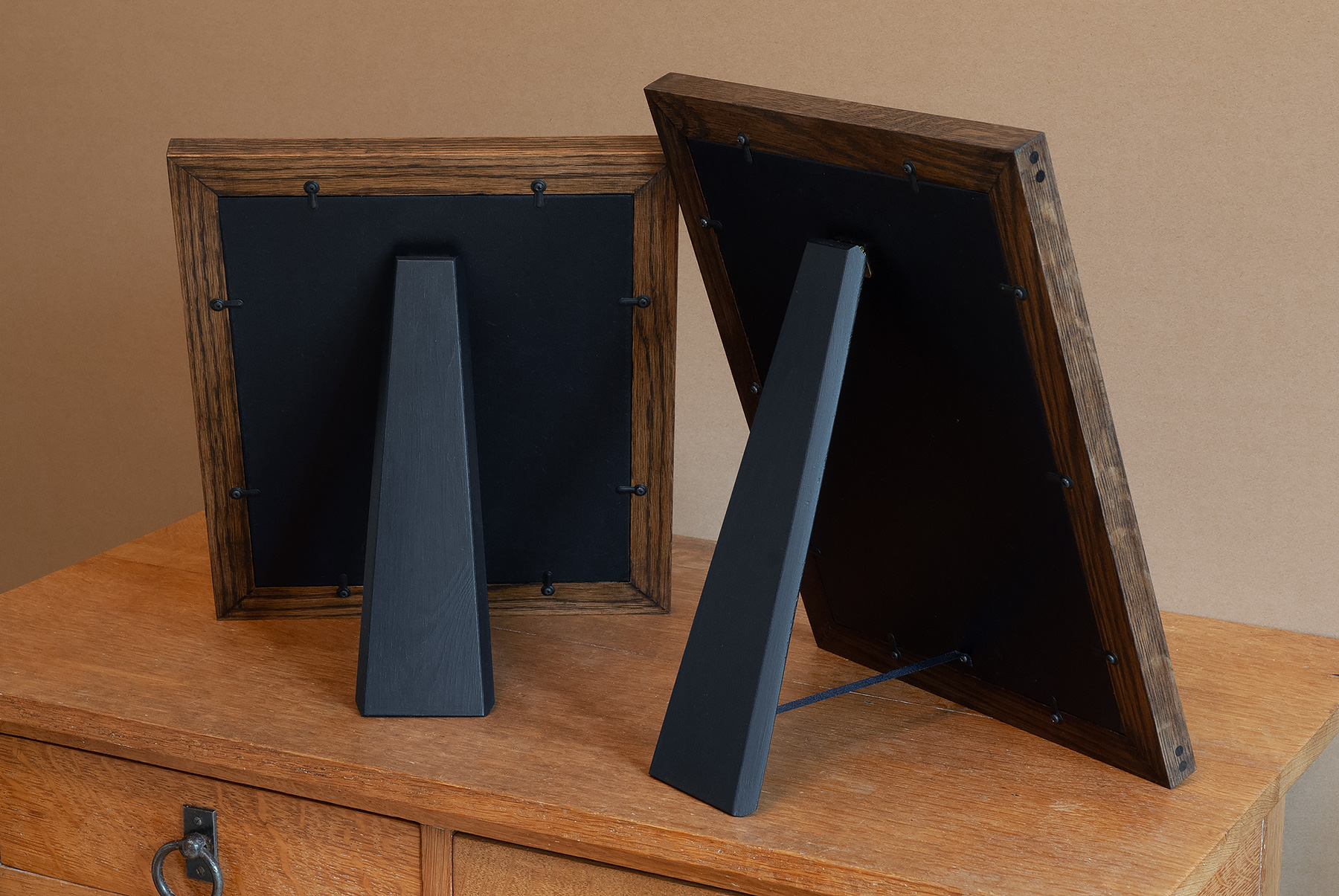

Post by David McCormack »
I made the struts from 10.5mm thick PAR pine which I picked up in B&Q. It was 92mm wide so that was a perfect width for the base of the strut. The overall size of the larger frame is approximately 12 x 15 inches.
I cut the struts to length and chamfered the short edges on the Morso. I then cut the trapezium shape by hand with a tenon saw and chamfered the long edges with a bench plane.
The backs are 3mm mdf. As I was planning on using brass hinges held in with screws, I needed to beef up the mdf. I glued a small piece of 6mm obeche (R&H F15) to the back of the mdf to give the screws something to hold on to. I also glued on each edge a length of SL4 to make the back nice and rigid. This also provided the necessary packing to bring the mdf up flush with the back of the frame.
I painted the struts and backs with Prussian Blue acrylic and Polyvine dead flat varnish. The hinges are attached with 10mm screws. As the hinges open up to 90 degrees I needed to attach some ribbon to act as a ‘stop’. I used 10mm grosgrain navy ribbon and folded over the ends and glued with Evacon-R to make sure the ribbon wouldn’t fray and would be strong enough when screwed in place. The backs are held in place with black turn-buttons.
As with a lot of new projects , it is the problem solving that can take up your time. Once I started this job it didn’t take too long to complete and I will certainly make these strut backs again. I only make hand finished frames and it seems right that the strut backs should also be hand finished.
I’ll see what my customer thinks of them tomorrow :D

I'm just wondering what you think about the potential for further sales for quality strut backs. I'm thinking about producing some top quality hardwood ready made frames with box jointed corners. I would need to produce my strut backs to a lower specification than your own and they would be jigged and the back and the strut cut on a table saw.
The quality of what we can buy from normal distributors has been gradually coming down to whatever quality equates to the lowest price, which I think is nuts because the difference between what framers can produce is not of sufficiently discernibly better quality that the cheap imported stuff sold by shops which have nothing to do with picture framing whatsoever.
As time goes on, I am always looking to produce items that are perceived as being superior quality to appeal to those who are looking for something special and are willing to pay the extra to get it. I imagine that your strut backs took a fair bit of time to produce and wondered if these are just specials for own customer, or are these intended to be something that you will also produce as stock items as well?

These two frames were a one off bespoke job for a regular customer who is always willing to pay for quality handmade products. They were supplied complete with the photos mounted and framed by me i.e. not just sold as an empty photo frame.
I don't get asked for free standing frames that often and have in the past just used pre-made mdf strut backs, but never liked them at all. When asked for free standing frames by this particular customer, I knew I could have a go at designing and making a handmade strut back and that they would pay for a hand crafted product. They did take some time to make but they will be much quicker to repeat in the future, now I know how to make them. If asked by any other customers, I can now say my strut backs are hand finished, just like my frames.
But I don't stock finished fames so I won't be stocking any finished strut back frames. I'm only a small home-based business and just frame to order. I guess the thing about stocking photo frames is that people buy the frame and take it home to put their own photos in and the strut needs to be designed to stand as an upright or landscape, which my struts are not!
So the truth is I'm not sure what the potential is for quality strut backs on ready made frames, albeit quality ready mades with beautiful boxed jointed corners like the ones you're talking about. As part of a bespoke job yes, but for ready made photo frames I guess it depends on your location, type of customers and what sort of shop you have. But if you think you can sell quality ready made frames then they deserve to have quality strut backs!

I'm preparing to upgrade to a better router when I get the chance and this will leave me with two quarter inch collect size routers surplus to requirements, so I'm thinking about making a jig with both routers permanently mounted into the jig to cut the profile and add a small 45 degree mitre onto both the struts and the backs.
The plan is too feed the strut back materials in their own jigs through a accurately made tunnel with the router and dust extraction located in the middle of the tunnel, as a result the air flow is being drawn by the extracion system from both the entry end of the tunnel and the exit end and should not allow any significant level of dust to escape at all.
If this works to plan, I will be looking to make these strut backs from 12mm MDF. Previously, I was planning to avoid machining MDF due to the hazards from MDF dust, but I'm thinking that this should solve this issue.

I was just wondering, Mark, if you thought of using say F7 R&H flat fillets instead of 12mm MDF. F7 is 9mm thick and a quite wide 74mm obeche. I say this because such thick MDF will quickly wear down your router bits. And if you foresee any sort of production quantities, then the cost of new cutters could soon mount up.
If you wanted a wide strut back, you could glue two or three fillets side by side on a bed of 2mm MDF.

I had no idea that MDF would be a problem with the router bits, I just thought it would save money to use MDF, obviously the wrong move! Most of my router bits I got from cheap sets and they are not tungston carbide, so I guess it will wreck the bits. Thanks for pointing this out.
I'm thinking about perhaps mounting the R & H F7 onto some 2.25mm solid kraft board that I already stock, it very dense, stiff, cuts very cleanly and I think it's as stiff as the 2mm MDF, plus I always have plenty of kraft board off cuts. Thanks for your suggestion.
