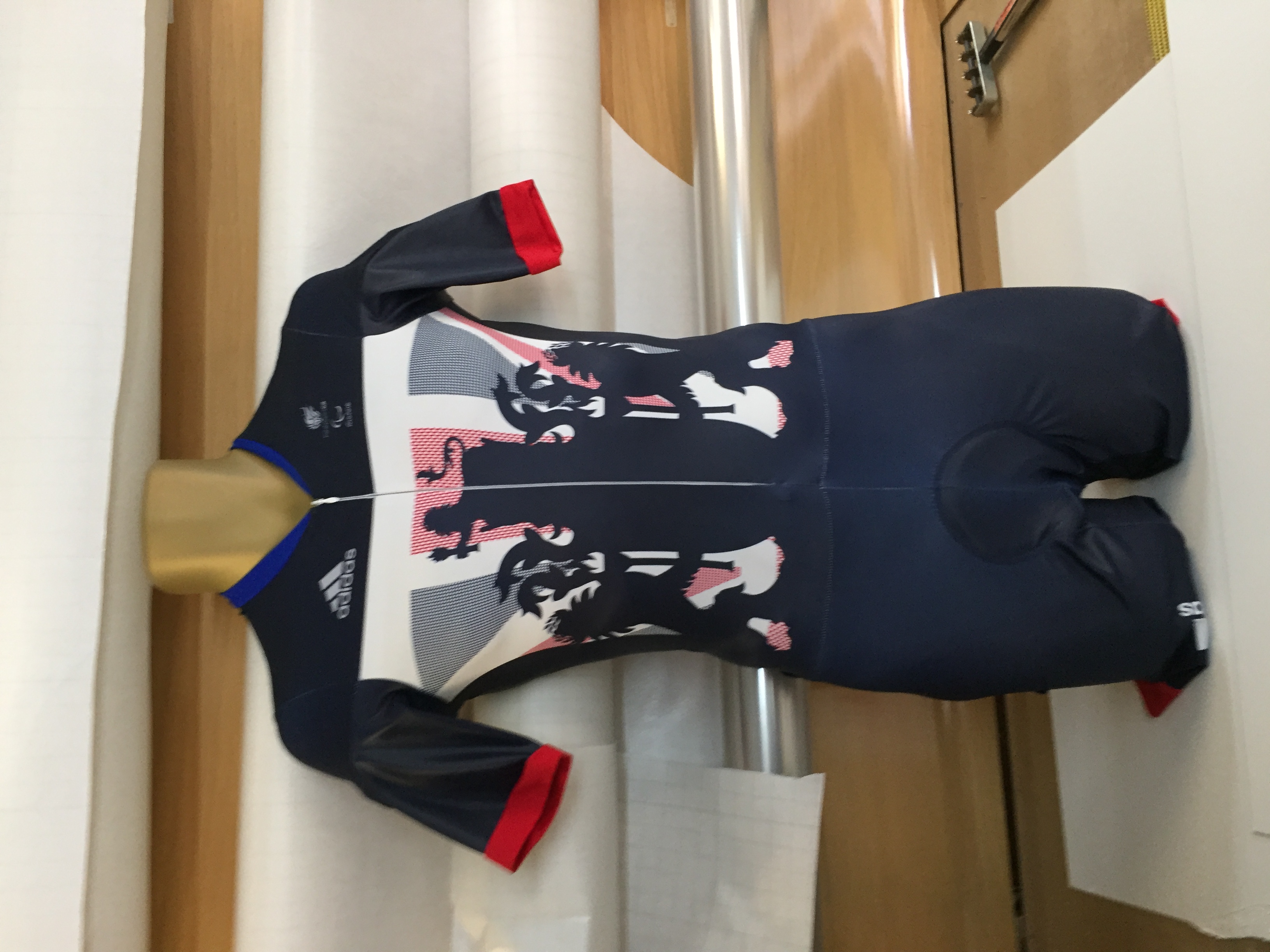

Re: Framing a bike cycle suit
Here’s one I’ve just started. It’s on a 3/4 plastic mannequin bought on eBay for £12 delivered
Going into a deep box frame
- C32464AA-A49B-43E3-8FBD-13367A6C5F10.jpeg (1.48 MiB) Viewed 6210 times
- Posts: 17
- Joined: Mon 21 May, 2018 8:21 am
- Location: West Lothian Scotland
- Organisation: scotframes
- Interests: framing, mind coaching, life
wow looking good, ..... I may use this to show customer if that's ok
..... initially when I mentioned 3D his response was they had no space, thanks again....
- Posts: 673
Feel free to show the picture. The body is hollow, light weight, approx 25” high and 16” wide, so quite compact.
